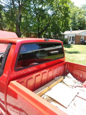

I have been looking for a third brake light for my 87 RAM50. I have found a couple on line for about $150 a little steep I think. I was at the junk yard and found a 94 Mighty Max with one I bought for $10 SURPRISE!!!
http://www.mightyram50.net/vbulletin...id=27370&stc=1

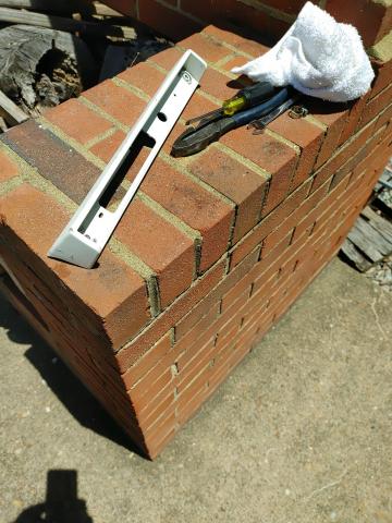

I took the thing home cleaned it up and checked it out. It didn't work SURPRISE!!! So I started carefully separating the lens from the base and the LED strip was held in with 2 screws.
http://www.mightyram50.net/vbulletin...id=27371&stc=1 http://www.mightyram50.net/vbulletin...id=27372&stc=1

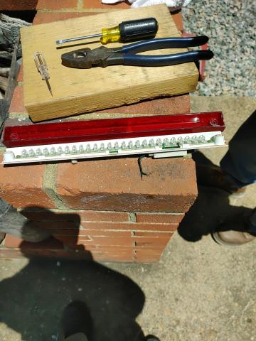

I figured I would take a chance and order a light off amazon the first light I ordered was a 32 bulb LED third brake light. I disassemble the light and the strip was a little short. I ordered the 40 bulb LED strip for $16 and it fit perfect, I held the the strip to the base with 3 dabs of silicone.
http://www.mightyram50.net/vbulletin...id=27375&stc=1 http://www.mightyram50.net/vbulletin...id=27373&stc=1 http://www.mightyram50.net/vbulletin...id=27374&stc=1
