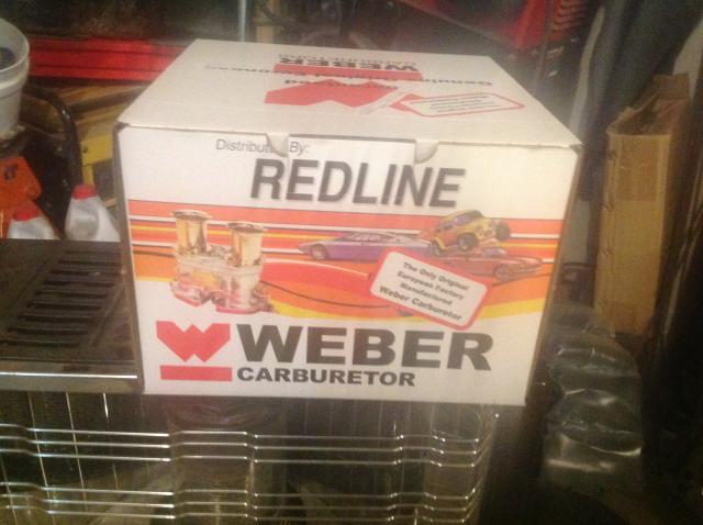

http://www.mightyram50.net/vbulletin...id=27085&stc=1Looky what showed up at my house. The beast will hopefully live this weekend.
Got her all put back together. Runs pretty good. Needs some fine tuning. Now I may have to pull the tranny. Sounds like the throw out bearing is about to give up the ghost. Idling in neutral it makes quite a bit of noise. Push the clutch in and it gets quiet.
