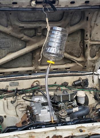

I ended up making a radiator bleeder from stuff I gathered around the hardware store. Worked surprisingly well. I get hot air on idle now. Having air in the system definitely affects the heater. Before using my homemade bleeder I had cold air blowing out the vent with all settings on hot and engine fully warmed up. I wondered why it wasn't blowing hot air. So I did some research and came to the conclusion that there was air in the coolant system. Watched a couple videos on how to bleed the coolant system of air and everyone seemed to use that big funnel that attaches to the radiator feeler neck. I didn't want to wait to get one in the mail, so I just made my own version:
Attachment 27087
I could have attached the pinesol bottle directly to the rubber stopper, but it's cool to see bubbles come up the hose and I heard the higher the container, the better the air escapes the coolant system. I don't know if that's true? May someone please help me understand the concept of how air escapes a coolant system?
I gather if the radiator cap or coolant recovery bottle are the highest point in the cooling system, any air in the system eventually migrates and collects there and doesn't need to be bled, so it's only when some other part of the cooling system is the highest point, such as the head, that you need some way to bleed air from that point. Since our trucks have the rad cap as the highest point, they don't need air bled out.

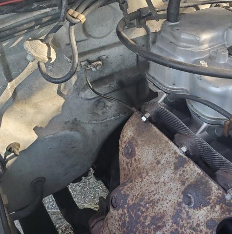

P.S. I noticed in your photo the ground wire from the firewall to the head is disconnected, in case you weren't aware. You'll wanna reconnect or replace that. A generic braided ground strap from an auto parts chain store worked fine for me, albeit a bit long, so I attached it to an intake manifold stud instead of an exhaust stud, which was easier to unscrew and took up much of the extra slack.
Missing or bad grounds can cause a lot of random electrical faults like struggling starter motor cranking, blowing fuses or intermittent light and wiper faults etc. It can also do some really weird and unpredictable stuff like trigger electrolysis in the cooling system (it can turn the coolant acidic and cause it to eat out a copper core radiator and heater core + corrode alloy in the head and intake manifold)
That particular ground is also the primary ground for the spark plugs via the head, so can lead to weak/sporadic spark if left disconnected.

Thanks guys. I'll hook it up to the exhaust manifold stud. That's the closest it seems to reach. Here is a picture of how I did it:
