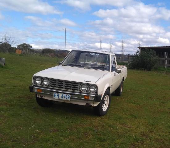

Here's the condition I bought it in:
http://www.mightyram50.net/vbulletin...id=27033&stc=1

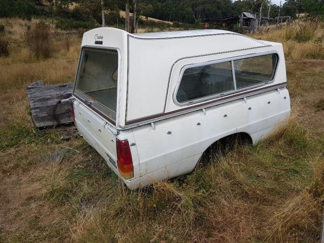

and drove 600+km to buy this stylish canopy:
http://www.mightyram50.net/vbulletin...id=27032&stc=1

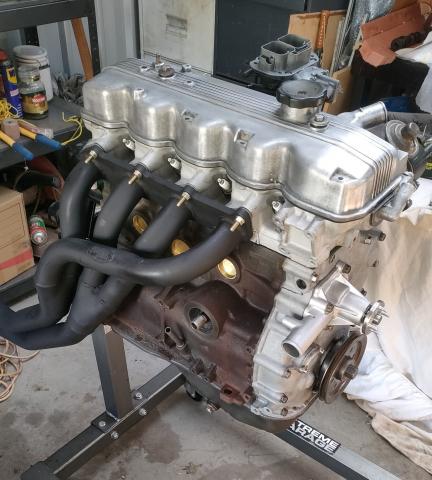

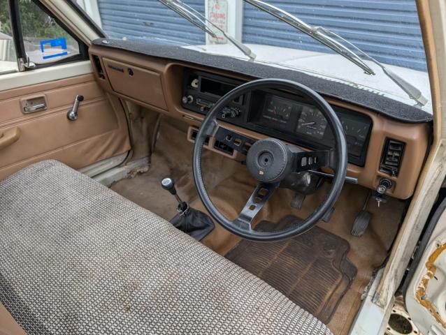

Other than lots of maintenance, I've fitted a torsen LSD, dealt with almost all surface rust, and put in a better dash from a parts ute I have (bent yellow '86 L200 with seized 4G63 and narrow 5spd). I have an italian weber 36/32 rebuilt to escort gt 1600 specs and L300 4g32b extractors that will need a a few inches off the end and a pair of 90degree bends welded on to clear the chassis rail.

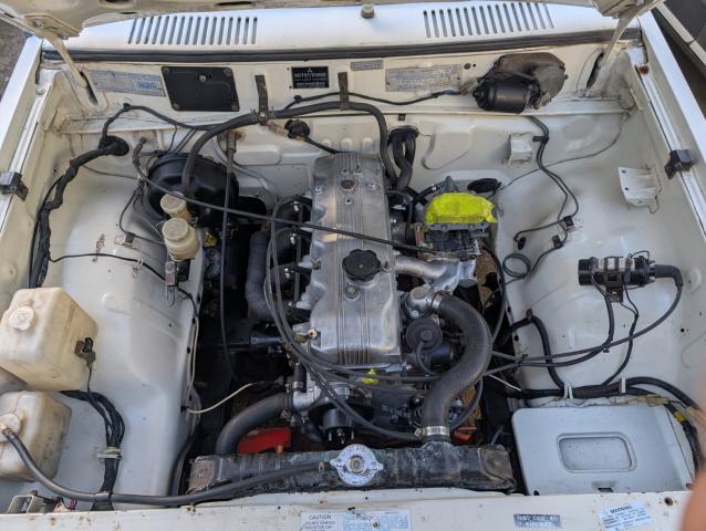

There was a minor overheating incident earlier in the year when a heater hose failed, so right now it's got chemiweld holding pressure in cylinder 4. I have a waterpump, timing belt kit etc for a major birthday soon, it just has to get through the Australian summer first, because it's a work truck.
Even after a rebuild the mikuni floods when hot, so I might start a thread to ask for help on that as I don't have all the bits ready for the weber swap yet and don't have time to pull off the tub and lay out electric pump etc. Plus I want to change out all old fuel hose when that happens.
