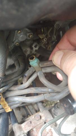

Hey guys. I've got a 88 Mighty Max. Last week, like an idiot, I broke a vacuum fitting off of the drivers side. The fitting has 5 vacuum lines running into it. I took the piece to 2 different part stores, and they both said that they couldn't get it? If anyone can point me in the right direction it would be greatly appreciated.Attachment 27028
You can make one. It’s just a manifold vacuum tree. You won’t find a new stock one. But you can go to a You pull it and pocket one
Or you can buy a billet one dirt cheap and tidy the mass of hoses up - https://www.ebay.com.au/itm/17503737...frcectupt=true
It may require re-tapping the thread to hook up a vacuum barb to the manifold where it has broken off. I haven't checked to see if there are any US vendors selling it but it's a lead...
Or if you convert to a Weber carb, you won't need that barb-tree at all and can just block off the manifold hole with a plug, once you extract the stub of the old tree. Note the threading is a weird spec, British Standard Pipe Tapered (BSPT) 1/8"-28tpi -- looks like this plug should work:
https://www.ebay.com/itm/122857847756
