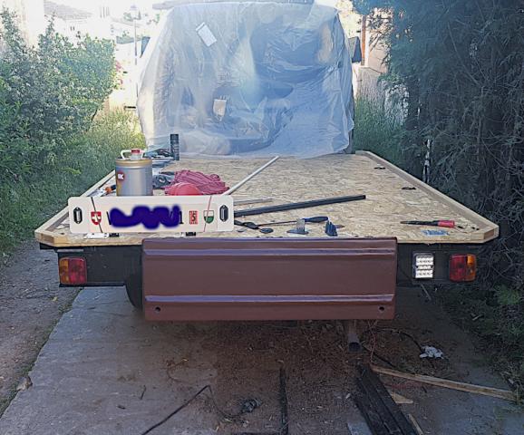

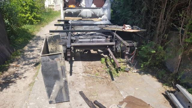

I am a French guy and not driving a mighty ram but a cousin. I found some months ago a L300 4x4 with a 2.0 G63B in Switzeland with a very low mileage (129.000 km -- I have the full service manual stamped). I bought it for cheap (as it had no French papers at that time) and started a restoration project. So far I have been working on the chassis and re-wiring / re-builiding tail lamps.The car is originally a RV but the camper rear was completely rotten and the previous owner removed it so for now I worked on building a wooden bed (cutting / welding new cross bars, doing some fiber glass for the box in the chassis, ...).
Here are some pics
http://www.mightyram50.net/vbulletin...id=26617&stc=1
http://www.mightyram50.net/vbulletin...id=26618&stc=1
http://www.mightyram50.net/vbulletin...id=26619&stc=1
As regards to mechanics, I have only changed the spark plugs and air filter for now. It is running too rich (spark plugs were very "clogged") and idling is not fantastic. The plans are to install a weber, new headers and to get rid of all emission control system + secondary air system (reed valve is gone and difficult to find) ... I will have to do my homework as the last time i dealt with a carb was on my Moto Guzzi Le man converted to a cafe racer ... long time ago!
Welcome STL
Your fabrication skills look perfect :thumbup: Hope that truck is easy on gas..?
Hi and welcome to mightyram. Old school Mitsubishis end up in the most obscure places. The original L300/Delica body was actually pretty practical for a camper/off road vehicle. A shame it was cut up for a camper - but good that you are rescuing it! Getting rid of the Mikuni and the emissions junk and swapping it for a carb like a 38DGES will make a world of difference. Post pics and ask questions :thumbup:

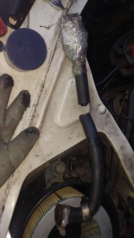

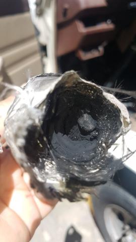

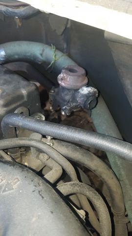

Another question: my reed valve on the secondary air system is dead - so is the pipe from the air filter
http://www.mightyram50.net/vbulletin...id=26649&stc=1
http://www.mightyram50.net/vbulletin...id=26650&stc=1
As you can see there was a repair with tape from the previous owner but the pipe was fully obturated :
http://www.mightyram50.net/vbulletin...id=26651&stc=1
I plan to eliminate the reed valve (with the plug on the pipe from the extractor) and plugging also the exit from the air filter box. Do I miss something and should I intervene elsewhere?
Thanks!

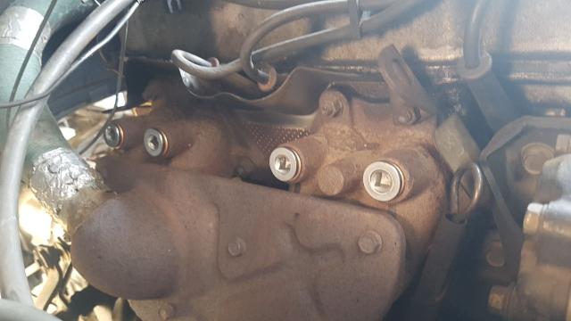

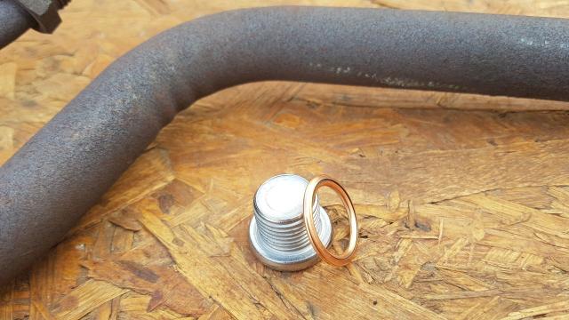

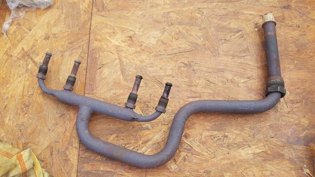

As stated above, I wanted to remove the secondary air system on the exhaust header:
http://www.mightyram50.net/vbulletin...id=26759&stc=1
If that can help other, the thread is M16x150 and a standard oil plug can do the job:
http://www.mightyram50.net/vbulletin...id=26760&stc=1
Here is how it looks:
http://www.mightyram50.net/vbulletin...id=26758&stc=1
Yeesh, the gas scavenging in European spec Mitsubishis is awful. Headers for L300's are available and will yield good improvements in torque. Added bonus is eliminating the EGR junk. A Weber carb will benefit having a set of headers as part of the upgrade. Adapting the air intake for a Weber can be achieved by using the carb hat from a Rover that came equipped with the 32/36 (you should have more luck sourcing one in the EU). Don't use an open air filter on the Weber as it will cost you torque.
...and nice work :thumbup:
those little exhaust port tubes....
i just cut the tube about 3/4 inch from the fitting, hammer the tube ends flat then screw them back in

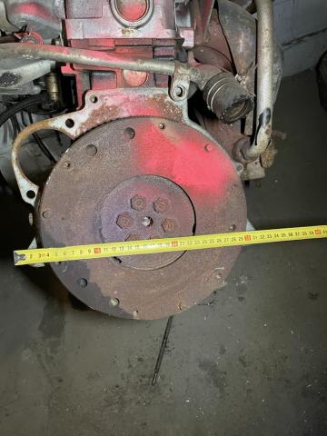

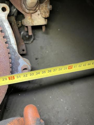

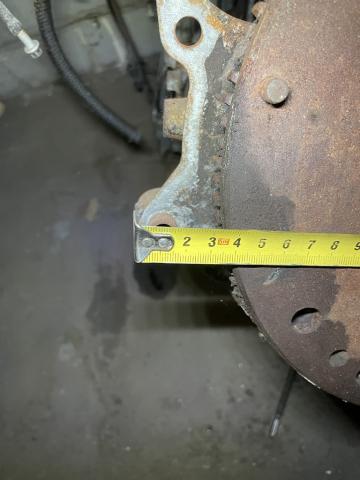

I received the metric measurements from the seller. I post them here as they maybe helpful for others too:
http://www.mightyram50.net/vbulletin...id=27348&stc=1http://www.mightyram50.net/vbulletin...id=27349&stc=1http://www.mightyram50.net/vbulletin...id=27350&stc=1
Removing the first 10/15mm at the left makes around 310 mm or the 12.5 inches that I found here and over the internet. This means that this is a narrow block (the egine comes from a 4x2 L300 so it is not surprising) and not a wide block (330mm or 13.25 inches) and because I own a 4x4 the engine won't fit.
Additional question: would the distributot from a narrow block fit in a wide block?
Distributors swap between all the 4G6X single cam engines. In fact, I've even used a points distributor from a 4G32 to run a G62B 12v Cyclone.
*addendum - the 4G64 is an injected engine and doesn't have the provision for the mechanical fuel pump in the head, so it would require an electric pump to supply the carb. An extra 400cc's would get it moving out of it's own way if this was the last resort for a new engine...
