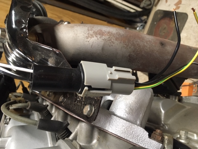

The original Starquest has a 1 wire o2 sensor bolted into the cat converter right off the turbo. You can keep it if you like. BUT this engine came with a replacement downpipe /cat eliminator and a screw in o2 sensor instead. Still one wire type but the shield did not fit , the one wire sensor was damaged, and three wire sensors make for a better running car as you get a good signal faster to the ecm.
http://www.mightyram50.net/vbulletin...id=26118&stc=1

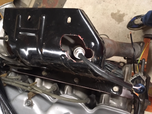

This is after I modified the heat shield to fit around the new location of the o2 sensor. I also swapped in a 3 wire o2 sensor. Bosch part number 13913, common on Fords. I also bought a replacement plug to fit it from Clips and Fasteners- part number fba19889-1. Doing the conversion is really quite easy, one wire is ground, one is power, one is signal. The replacement plug needed a couple wires swapped around but now it works, the plug can literally be disassembled and moved around with a screwdriver.

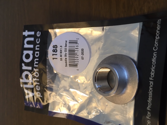

I also plan to run a wide band for a dash gauge so I got this nifty version of the weld bung. it's got a wider flange and is therefore less prone to damage and warping during the welding process- very good for a ham fisted oaf like me.
http://www.mightyram50.net/vbulletin...id=26121&stc=1

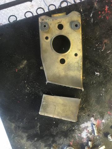

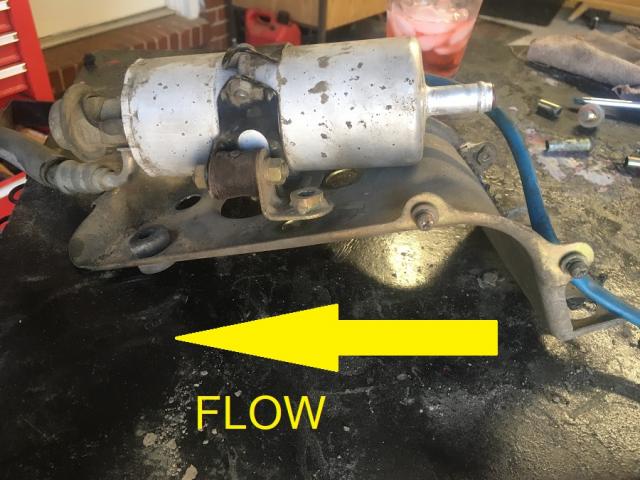

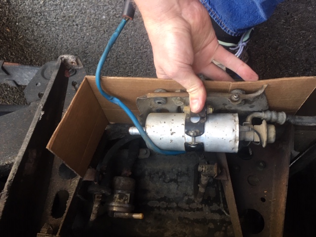

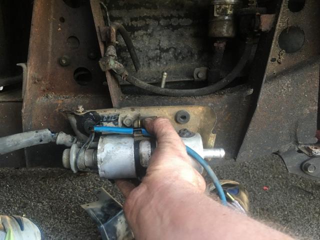

You gonna need a high pressure pump. I chose to use the stock Starion pump in keeping with the theme of " make it with what ya got and use stock parts whenever possible. Here, Ive got the stock pump and bracket from the donor, with the funny curved bracket
http://www.mightyram50.net/vbulletin...id=26215&stc=1
This bracket is great, it has two sets of rubber mounts, this helps keep the pump from vibrating against the body and making noise, but the dogleg is in the way so it has to go
http://www.mightyram50.net/vbulletin...id=26216&stc=1

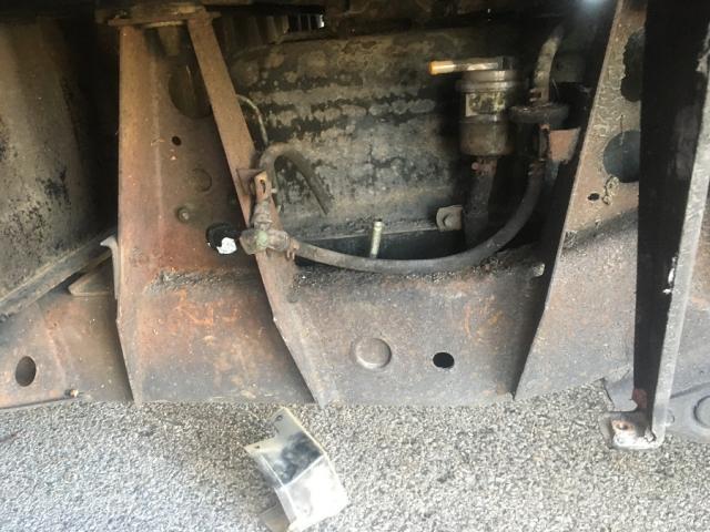

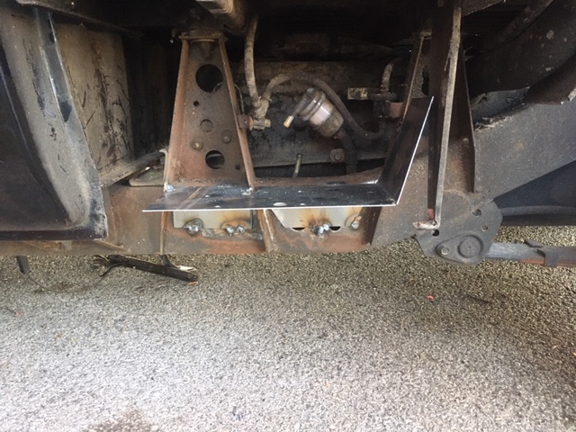

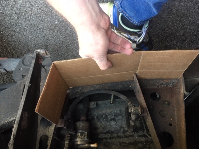

Cut away the crap and I've figured where I want it, under the side cover right by the tank, fuel pumps work better as pushers so low and close is the game, you might be tempted to mount the pump like this on the outside of the frame and be done with it
http://www.mightyram50.net/vbulletin...id=26217&stc=1

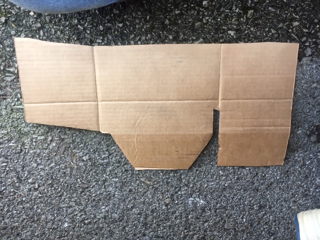

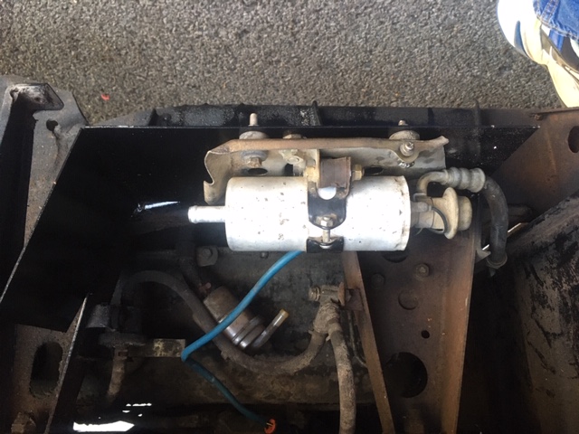

BAD, NO! the pump has no protection from rocks kicked up from the tire, and it's hanging off the rubber mounts that weren't designed to do that, they work under compression. It has to be mounted flat and up. So I get out the CAD (Cardboard Aided Drafting) tools and made this.
http://www.mightyram50.net/vbulletin...id=26218&stc=1http://www.mightyram50.net/vbulletin...id=26219&stc=1http://www.mightyram50.net/vbulletin...id=26214&stc=1
That'll do it. room to run the lines, a little kickup in the front to prevent rocks and it's still easy to get at, just take the panel off and voila!

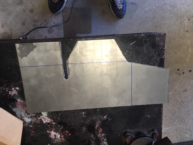

Here is the cardboard bit/metal cut out prior to bending. you can bend this in a brake or you can bend this in a vice or you can do as I did and lightly score it with the angle grinder before whacking the bejezzus out of it over a 350 block lying in the yard to get a crease.
http://www.mightyram50.net/vbulletin...id=26220&stc=1http://www.mightyram50.net/vbulletin...id=26221&stc=1http://www.mightyram50.net/vbulletin...id=26222&stc=1http://www.mightyram50.net/vbulletin...id=26223&stc=1
You can weld it (like me) or just sheet metal screw it to the frame rail. Don't try to through-bolt it however, the frame will just collapse without internal support.
