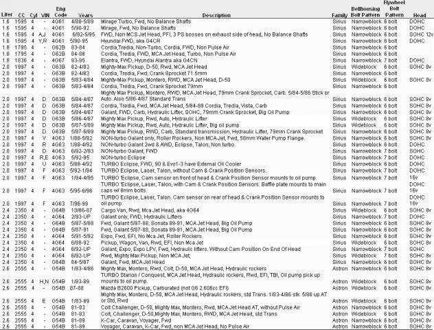

One thing I noticed - I also had an 89 2.0 automatic which needed an engine. The blocks between the auto and 5 speed had totally different bell housing bolt patterns. The auto block bell was much larger, although everything else was the same.
I bought a standard shift replacement engine and discovered this. WTF
