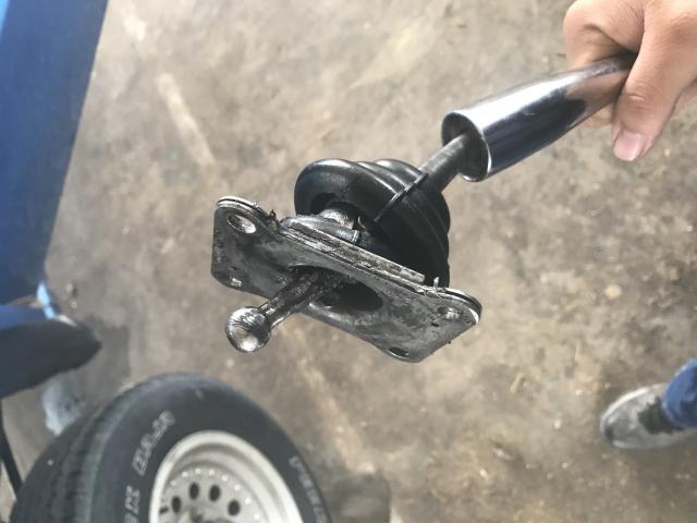

1 Attachment(s)
http://www.mightyram50.net/vbulletin...id=25726&stc=1
That is what the shifter I pulled out of there looks like. Do you see any issues with it??
It is missing the little nylon cup that goes on the end of it. Other than that it looks to be fine. I feel like someone on here found a source for replacement cups at some point in time, but I don't remember for sure.
Online cheap - they were also used in Hyundais as well so there are a couple of avenues to track them down. What condish is the central pivot ball like - not cracked or worn down etc?
The pivotal ball actually looks like it is in decent shape! Man I really hope this is why my transmission doesn’t want to come out of second. It feels like it is in neutral because the shifter is all loose.

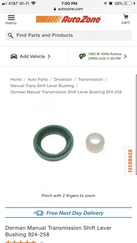

1 Attachment(s)
