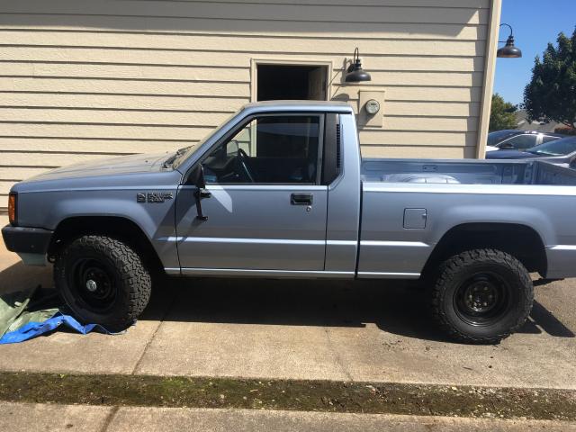

Nice looking '87. It's a very close cousin to mine, almost same configuration but mine is an auto.
