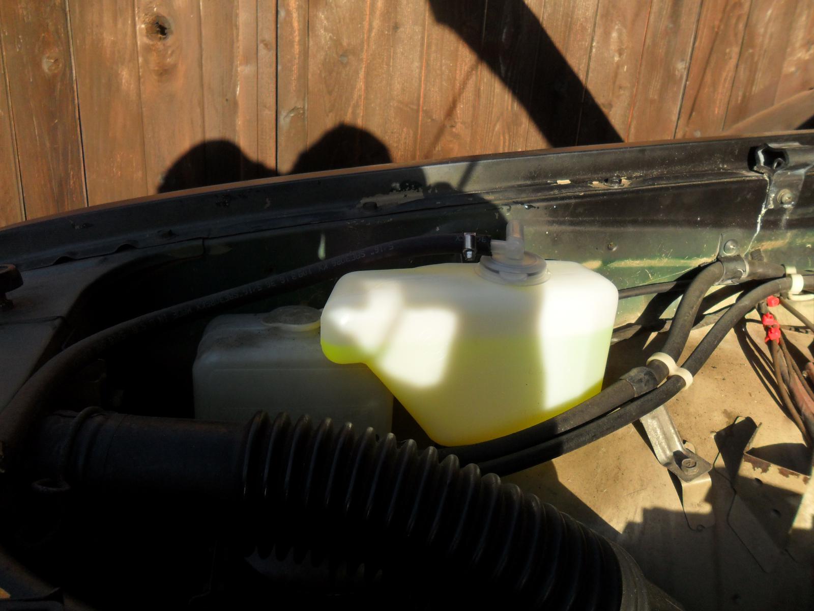

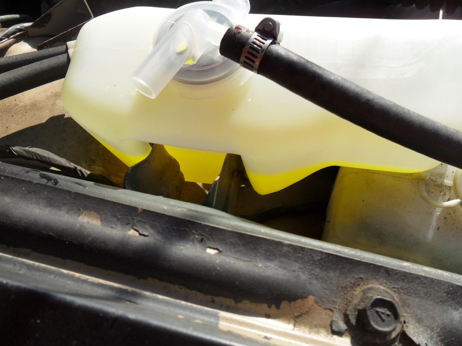

sometime between the trip and now it has developed a weird symptom where it will boil over when I stop and shut off the engine after a drive. It does it so much that the overflow bottle vents out the vent tube onto the ground. If I start the truck and let it idle a bit it will take all the coolant back in and stop boiling after just a minute of idling.
