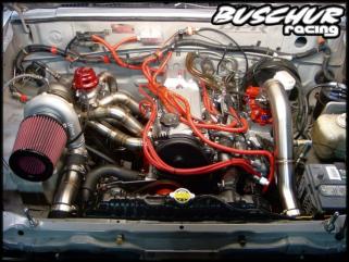

1 Attachment(s)
Sure you can get 200 HP. Just do this.
Attachment 25182
The G63B block is TOUGH. It's handle crazy amounts of HP for a stock 4 cylinder engine (easy double over factory). That picture that camoit has so kindly posted up for you is of one of our members' trucks before he sold it. As you can guess, there is a bomb of cash spent on it - it is after all the land speed record holder engine for a Mitsubishi 4 cylinder truck (built by LSRMike here) Get it right, improve engine performance (not just the max HP on a dyno sheet but torque, fuel economy, throttle response etc) and it'll be a totally different truck to drive. You can pull this off on a budget if you do a bunch of the work yourself. A carb and header mod will work their best after the head is ported. This is something you can totally do in a garage at home without air grinders and carbide tips. Getting a shop to do it is very labour intensive and most of the time you won't be happy with the results for what you've paid. Horses cost $$$. And the truth is, they are only numbers. If you really want a horsepower hero truck, visit the DSM/Evo tuner sites to see what goes into building a high power 4G63 turbo engine.
