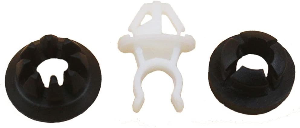

I found this kit on Amazon. It took forever to get here from China, but it did. And it works!
https://www.amazon.com/gp/product/B076P99SKF/ref=ppx_yo_dt_b_asin_title_o01_s00?ie=UTF8&psc=1
Attachment 25113
Here's the Amazon link again.
https://www.amazon.com/gp/product/B0...?ie=UTF8&psc=1
