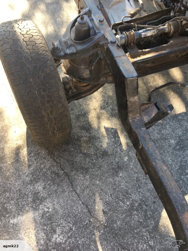

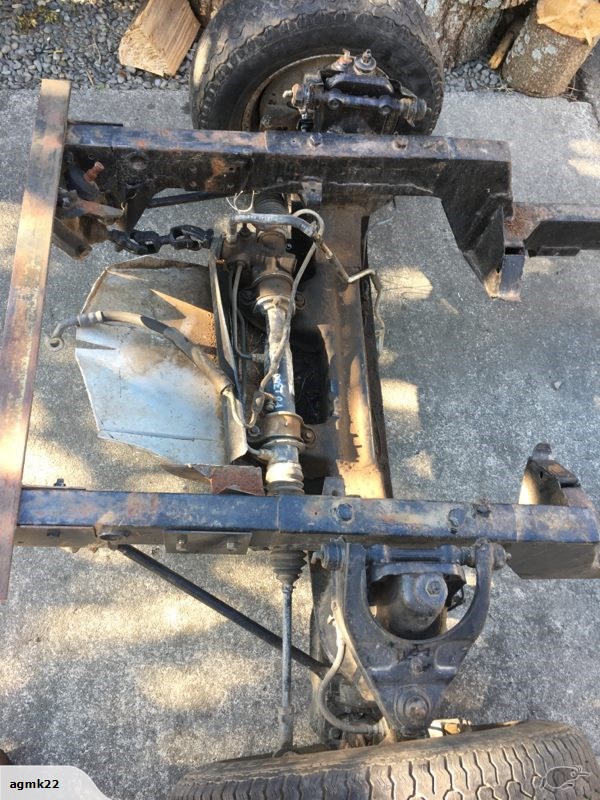

Thought you guys may be interested, there has been a few questions about fitting a rack and pinion to these trucks
This is an L200 front end (ram50, mighty max etc)with an L300 steering rack (the mitsubishi van based on the same equipment)
Attachment 24553
Attachment 24554
The chassis i dont know, its some kind of hotrod custom. But can give you an idea on parts
