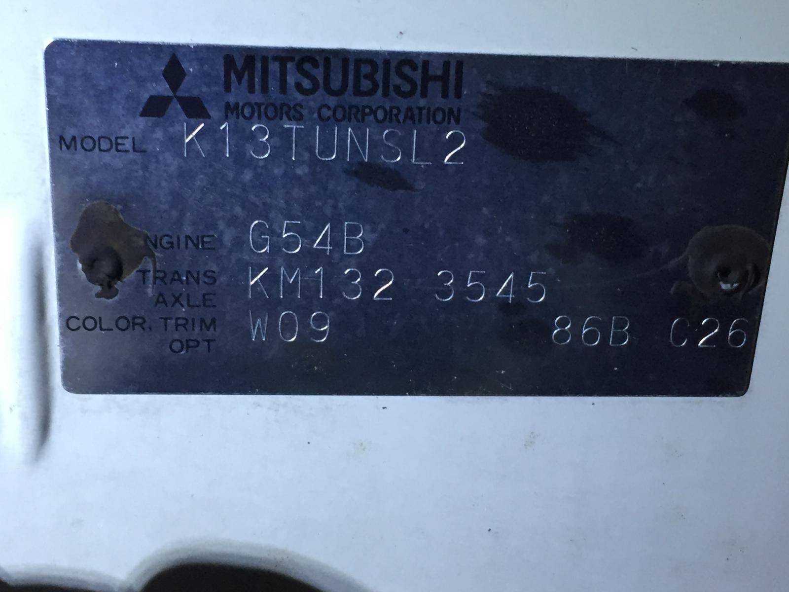

Previous owner used a spring and nut for a spacer on the old cable. I figured it was stretched and ordered a new one, but the new cable can be adjusted all the way up easily and still not disengage the clutch. I temporarily put the spring and nut on the new cable to be able to get it into gear. It is adjusted wayyyyy out and still not working normally.
The clutch fork lever at the bottom of the cable has atleast and inch of free play travel. I checked my spare trans still bolted to my other 4G64 and it has the same amount. Is this normal, or could I have a bent clutch fork? Something internal there has to be off.
Also, if anyone knows where to find that plastic ball end shifter bushing that goes into the trans please let me know. My spare tranny didnt have one either.
