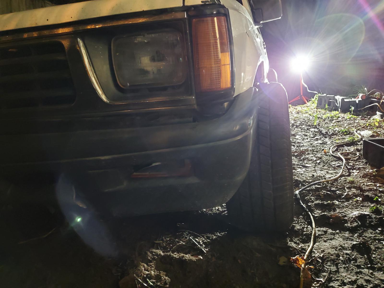

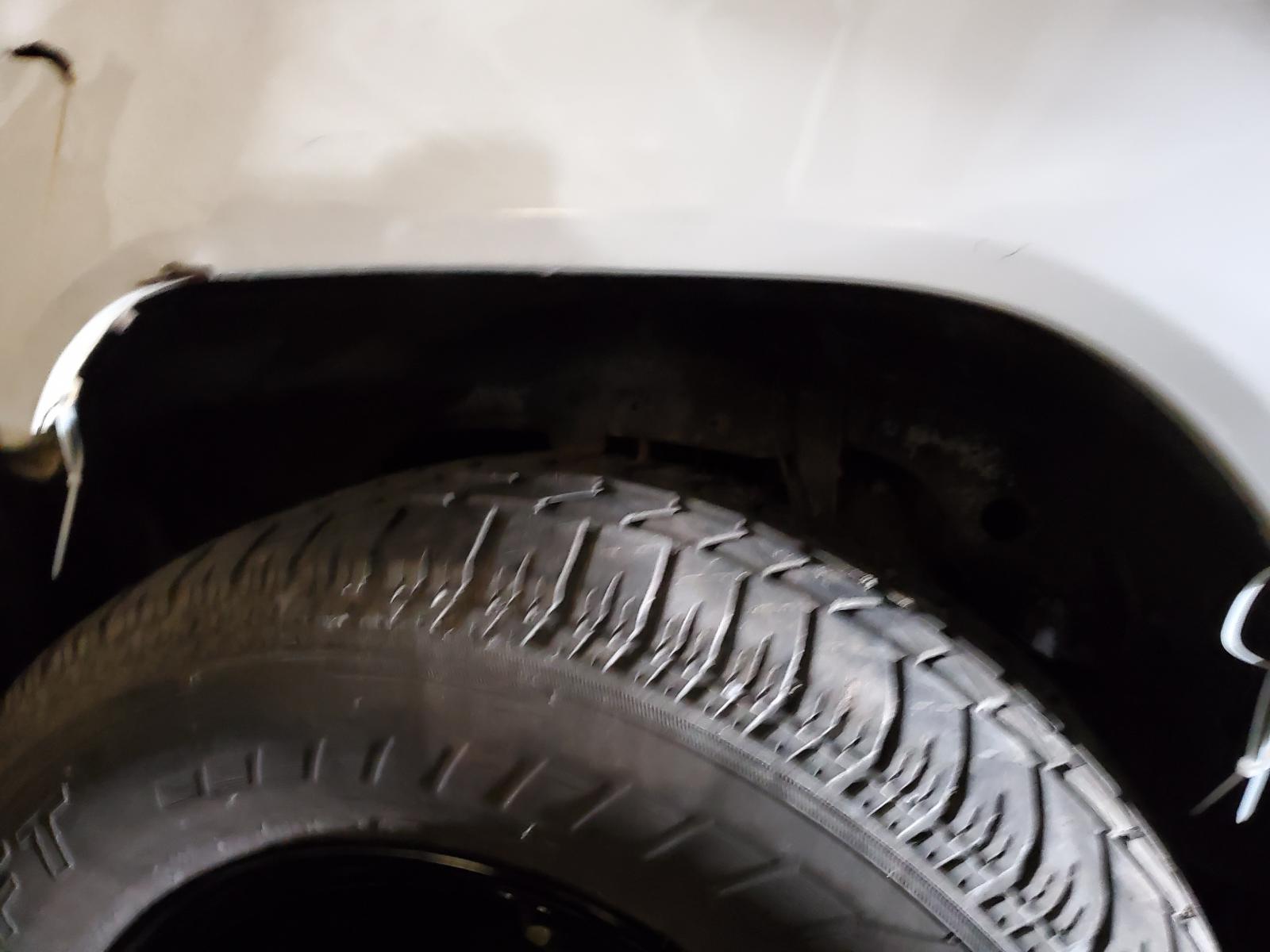

I have had a change of heart with my truck, and decided not to lower it as it will pose a problem with my typical use for it. I got my hands on some old school eagle alloy wheels, 15x8s, and they have a LOT of offset. I'm not against cutting the fenders, but would prefer any alternatives. I like the way the truck sets with the wheels, but if I could get 2 more inches of height in the front I would be happier.
I've look around on the forum and have found quite a few old threads about using John Baker (can't find any) or having custom springs made. I also saw that Ranger springs may work, which means if I van get a higher lift speing for a ranger then it may be what I need?
Of course there is the issue with the control arms and such, but I am not looking to go up a whole lot. It may see a SAS in the future. But that will be next year after the baby arrives at the latest.
Take in account the front is setting higher in this picture because I have a complete spare engine and trans in the back of the truck making it raise up a little.

I like the look, and honestly I would leave it, or maybe even lift it. If its 2wd it's on the ground if it's a 4wd say hey to the Cessna airplanes!
Here are a couple of guides to follow with suspension and wheel offset. Excessive wheel offset (above pic is a prime example) will cause bump steer. It ain't fun or safe. If you haven't experienced it at speed, keep a clean pair of pants in your truck and your distance from other cars - and that's on a dry road. In the wet, have a tow truck business card in the sun visor and a pre paid funeral plan in the glove box ready and waiting. With control arm suspension like in a MM and a lot of older cars, the extra offset is rough on control arm bushes as well so if yours is already tired this will chew them up. Add raising the suspension height on top of this - raising the centre of gravity in a vehicle negatively affects handling and road holding. I can't tell you what to do but if I advised someone to do the above mods, I'd deserved to get my ass handed to me. I know it sounds like I'm being heavy handed, but it's better than finding out why we haven't heard from you in 6 months from a FB post about you dying behind the wheel...
A small increase in offset, lowering the ride height, adding a stiffer front stabiliser bar and dialing in the front camber - you get handling and more sensitive steering response. This is a far more enjoyable driving experience than choppy handling and feeling like a front tire is going to tuck in under the front of your truck and disappear.
I have run large offset like this before on small trucks time and time again. Never personally had an issue with bump steer, even on a 4X4 locked in high hammered down. I know making changes to overall scrub radius can cause wondering, or a shaky feedback if you have worn out parts, but I've never seen it cause bump steer myself. I always buy moog suspension parts and polyurethane bushings with no issue on wear if anything poses a problem. The ball joints and hubs will hate me of course, but never had one break.
I want to raise the front because if I hit a bump I'm sure the fenders will catch some tire. I was debating on pre-running it. I may just have to pull out the welder and run an I-beam or long travel cross steer setup.
thats true, but if you don't go 100 mph around a hairpin your tire shouldn't fold. I personally have never been in a bad handling lifted truck. except for Ford, dad has a 08 and the tire folds like paper, as well as the 78 because of the offset spindles (but its actually lowered a bit) but I have never seen a lifted truck with bump steer. now I have actually driven a lowered car and experienced bump steer. its a Lil scary. but if it were mine it would b factory height rear and leveled front. don't bother squatting, unless you wanna say hello to understeer on a wet road and wind up wrapped around a tree like my friend did last Monday.

Yeah I'm hoping 2 inches will level it out. If it ends up being a little too high I can always add a helper speing in the back.

I plan to trim the fenders a little for turning radius mainly, but if can be avoided not just hack them or waste time making large flares on stock control arms. I believe leveling the truck will prevent the top of the tire hitting the fenders, if not, a little off the top won't hurt.
