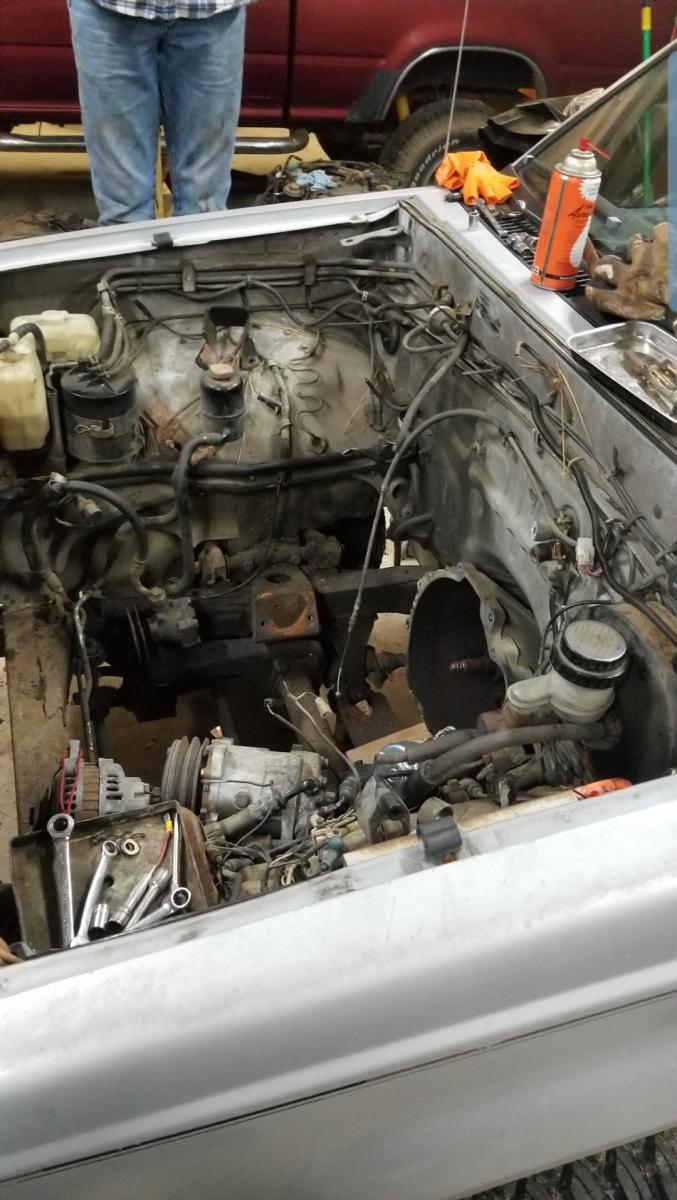

5 Attachment(s)
I am gonna redo it all, gaskets oil pump water pump alternator belts distributor plug wires plugs and the 87 intake which was better flow I think. I got the motor out today, I missed a ground strap. I'll splice it when the 82 motor goes in, no biggie. It was the one under the block.Attachment 24205Attachment 24206Attachment 24207Attachment 24208Attachment 24209
The second photo it was on Jack stands, that's how I want it to sit when I am through with it. It sits really low in the front now, that's gonna get fixed when the bed is back on and the torsion bar are reset, as well as a possible lift up front

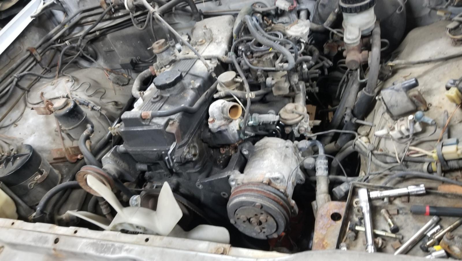

1 Attachment(s)
You can see the frayed wire behind the ac condenser hereAttachment 24211
