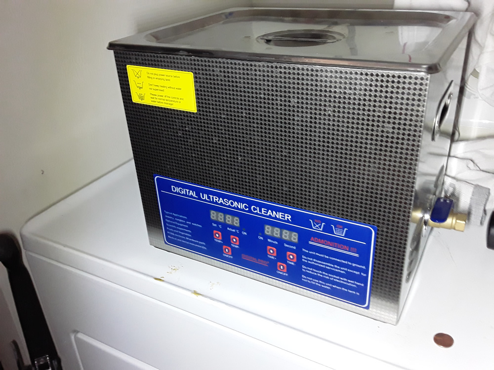

1 Attachment(s)
Just a cheap one from Ebay, 10qt for about $135. I just used water and dish soap, some people say simple green works better, others swear by dawn dish soap. Just a little, not enough to bubble, but enough to dissolve the grease.
Attachment 23474

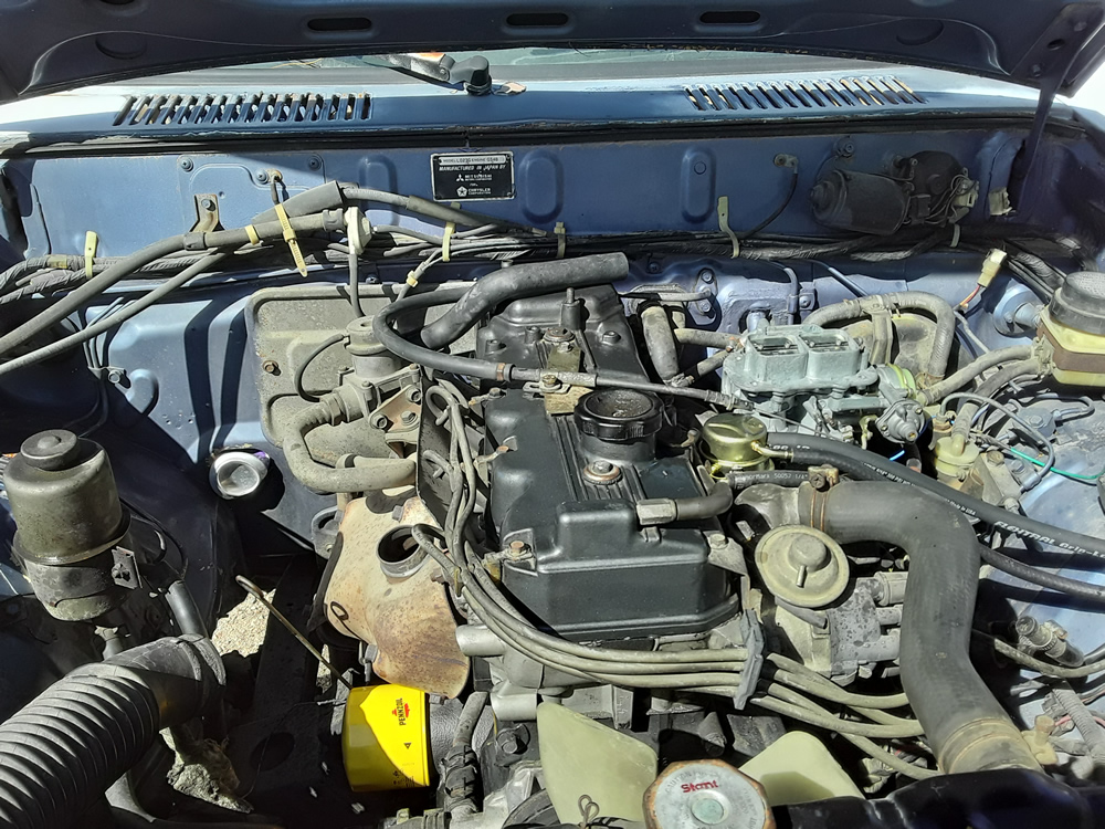

1 Attachment(s)
Fired it up yesterday, runs like garbage. Probably have to rejet yet again.
Drove it around the yard, no brakes, lol. I guess after 7 years the fluid dripped out. Probably get a new master and bleed it.
Attachment 23534
