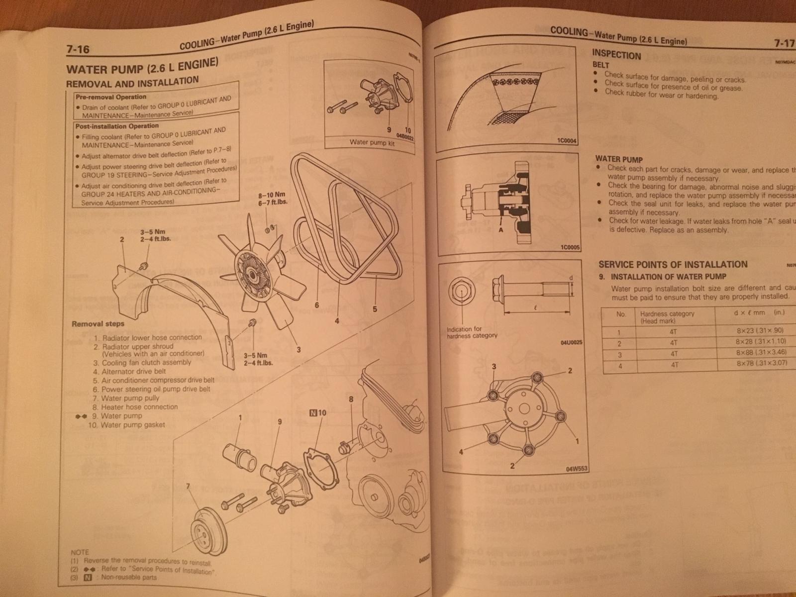

i have a 1987 Dodge D50 , 2.6 L , Automatic with A/C 85,00 original miles from new it was my wife,s fathers
It has not run/been used for 7 years and i Recently started to get it going again
i put a new battery in and did get it fired up fine , but after an hour or so it broke the fan belt

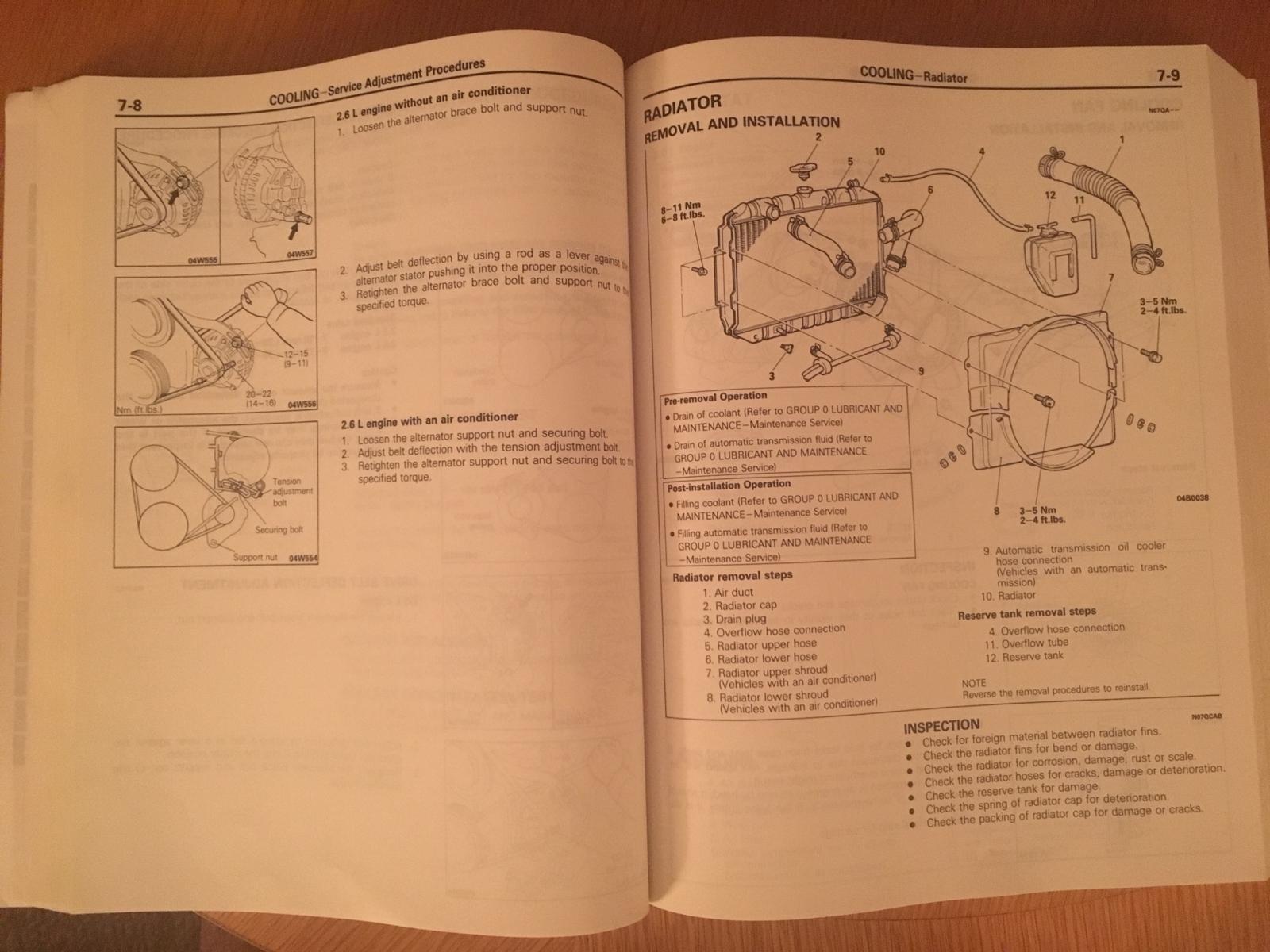

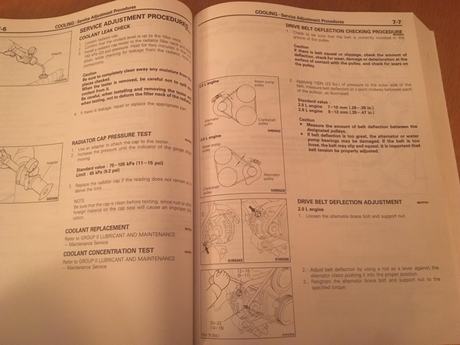

i went an got new belts but i cant find a diagram of how the belts are routed/Installed ?
I have ordered a manual but thats a week away
Any help would be useful

Hi Paul, welcome to the forum.
Here's a few pages of the '87 service manual that might have what you're looking for. I hope this helps and gets you going while your manual arrives.
Keep us posted, and if you run into trouble I'm sure someone here will be able to walk you through it.
Attachment 23285 Attachment 23286 Attachment 23287
