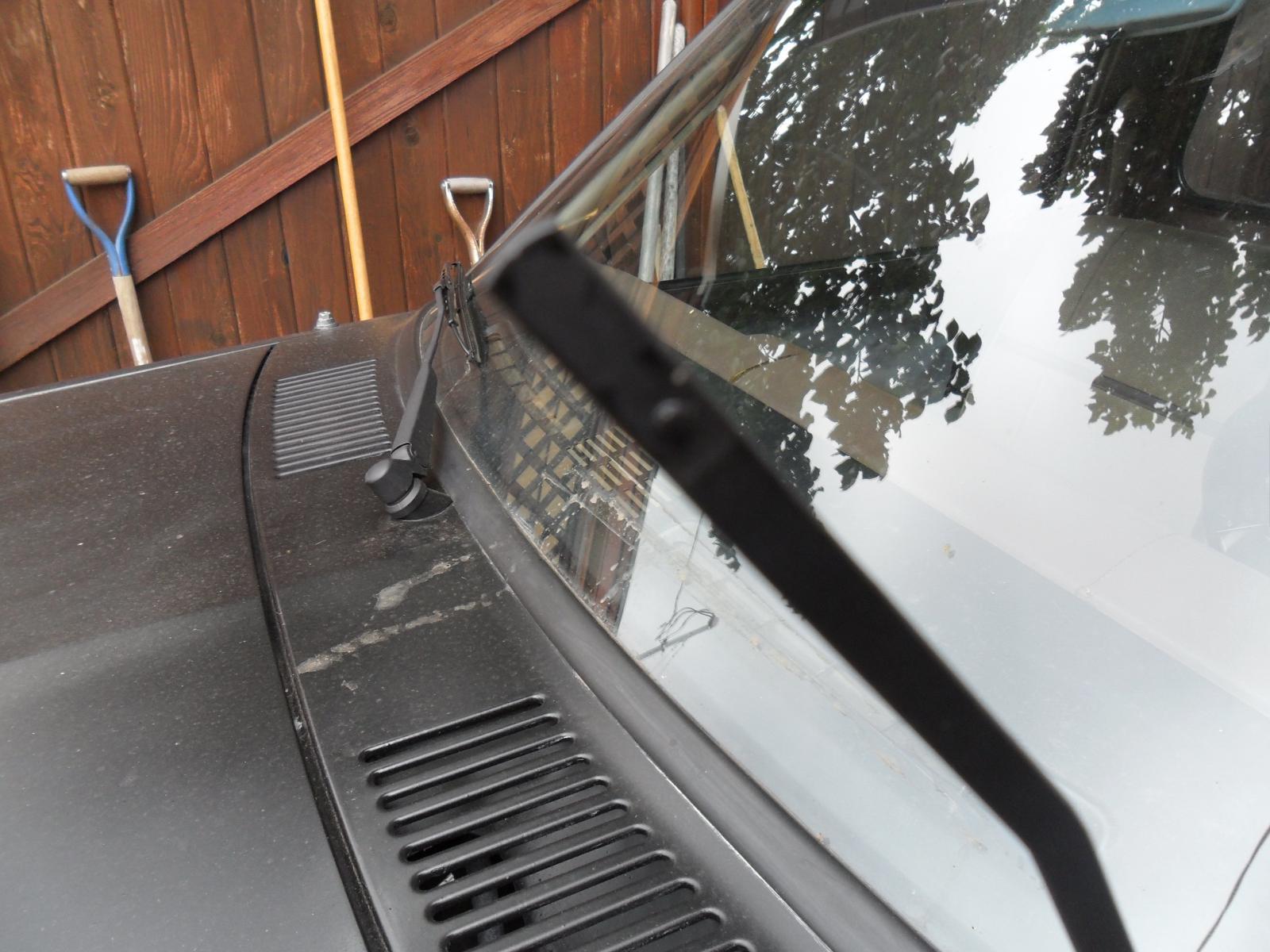

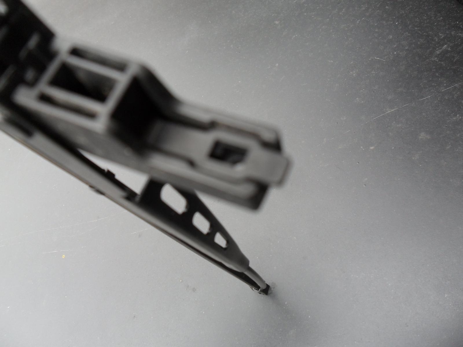

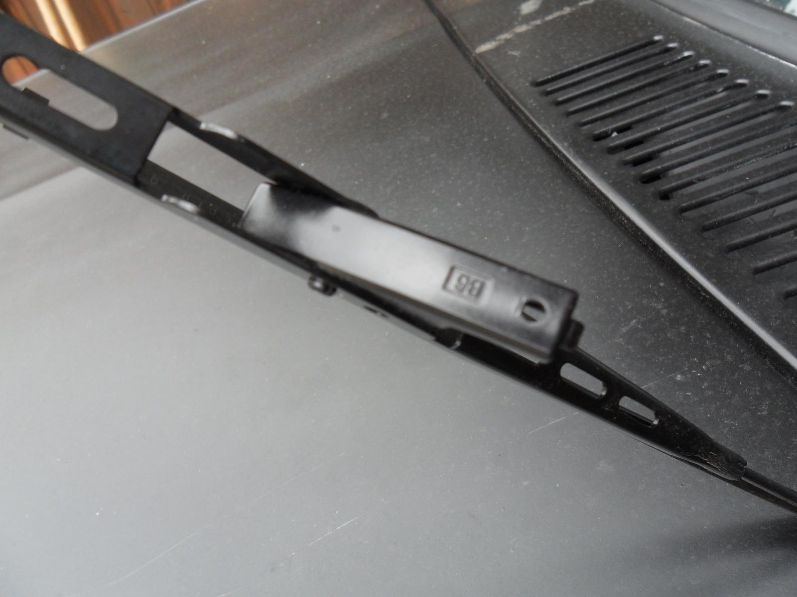

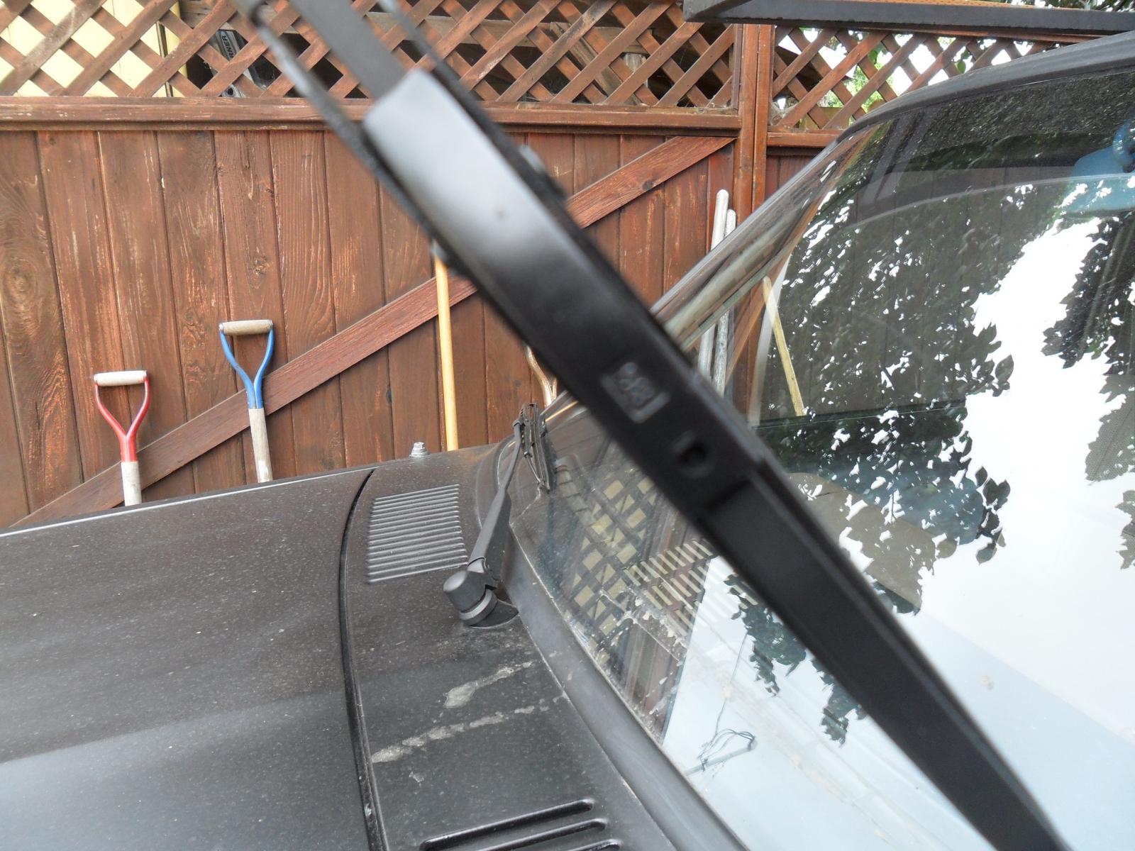

The bare wiper arm has a nub on it. The plastic clips of the right kind of wiper will slip on and that nub will lock it in place. There is a detent to push to get it off.
