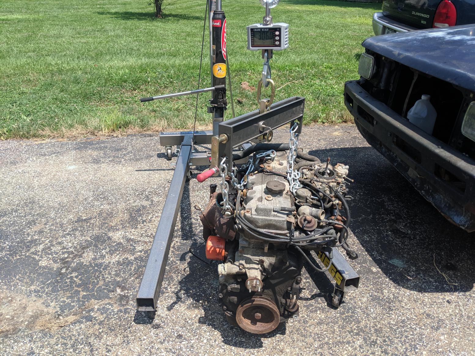

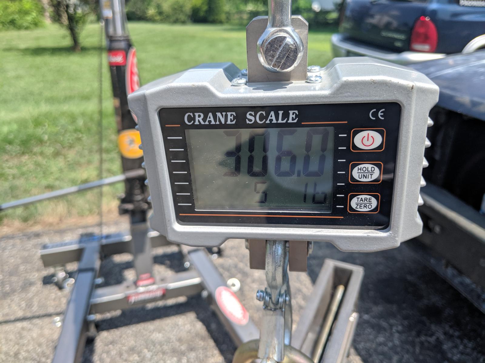

I was trying to find the weight of the 2.0 and 2.6. I just aquired an '87 ram and pulled the engine, It weighs 306 lbs. fully dressed minus the alternator. Thought I would pass this along as I could not find this information when I searched around for it.
Attachment 23009Attachment 23010

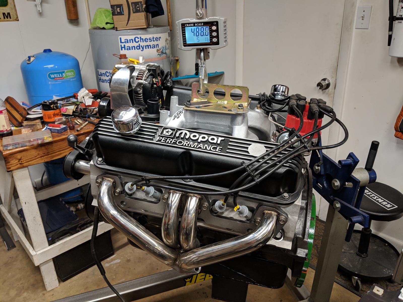

Also if you're interested in knowing the weight of the 360 with aluminum head I swapped out in my '86, it was 488 lbs.
Attachment 23011
