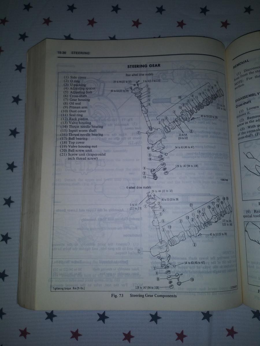

So I have recently completed a power steering conversion on my gen 2.
It works great except for the fact that after turning a corner it does not quite self center completely (the steering wheel does not return to straight on its own) and I have to turn it back myself
I have used a steering box from the exact same model triton and I have a pump off of a 4g54 starion with a built in reservoir on the back.
What I will do next is get a wheel alignment just in case, this shouldn't be the cause of the issue because it self centered under manual steering before the conversion. I will also replace the pump belt as this is second hand and came with the pump(even though it looks almost new)
Im worried the box is worn out, but hoping someone has had this issue before and it was an easy fix.
Any ideas what it could be? Anything should try to fix the issue?
