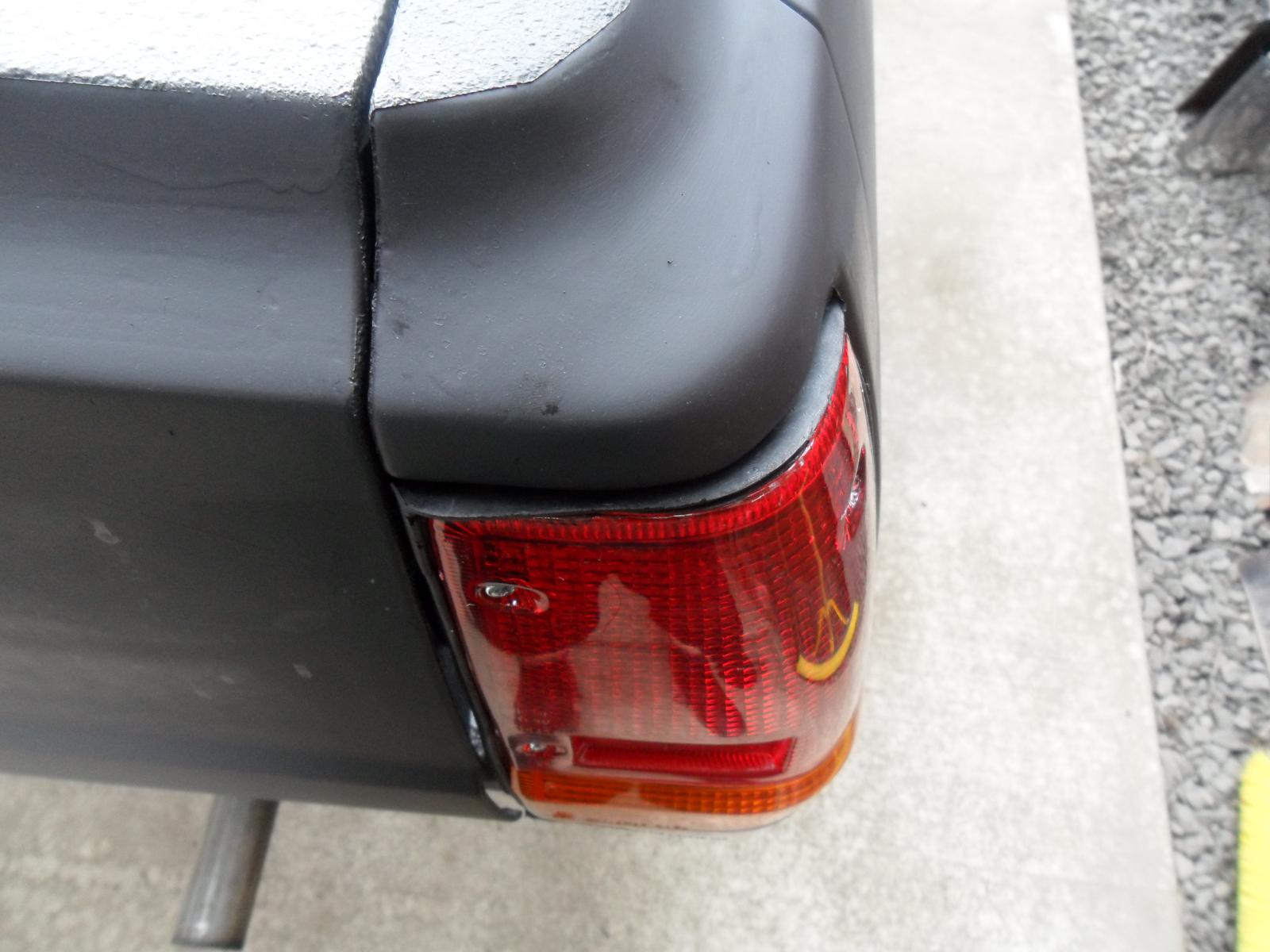

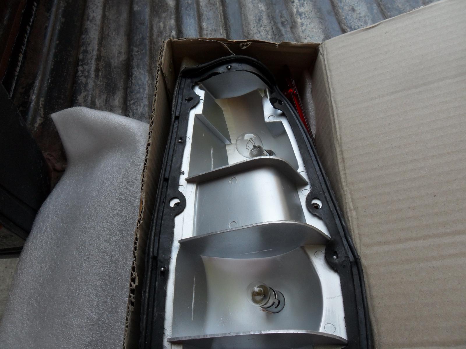

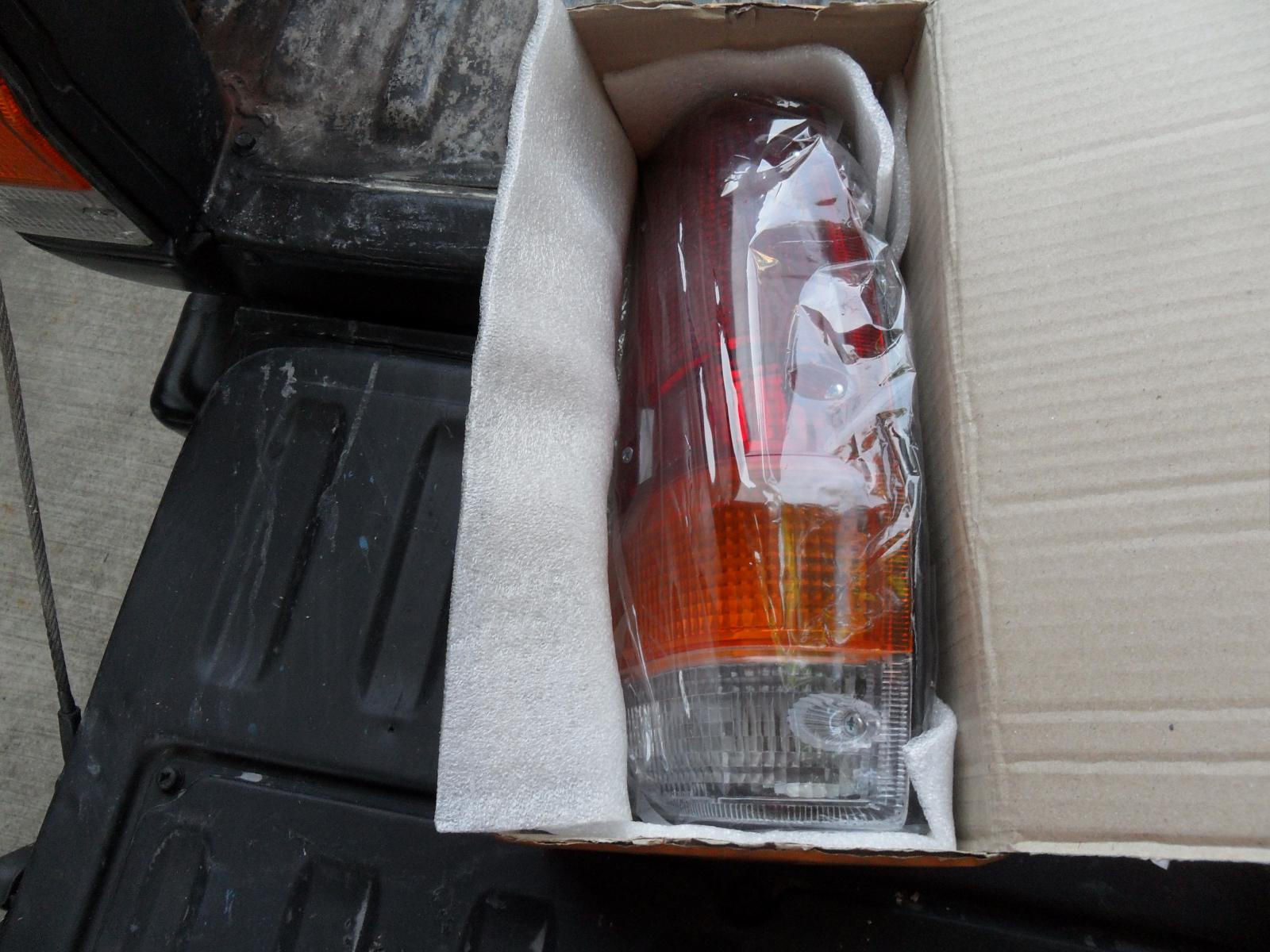

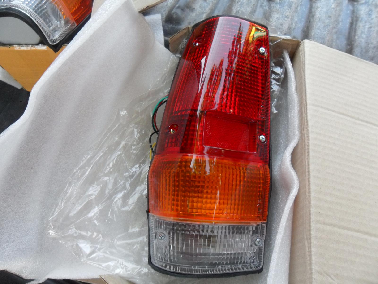

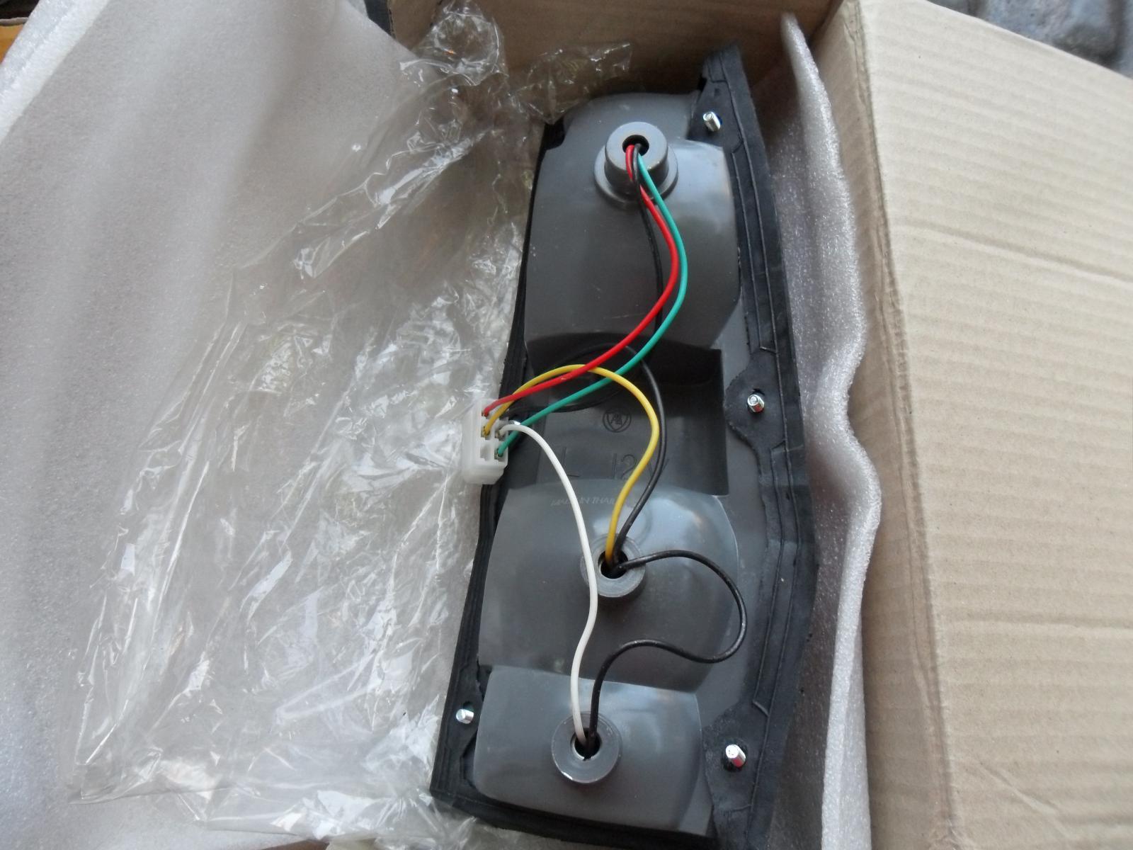

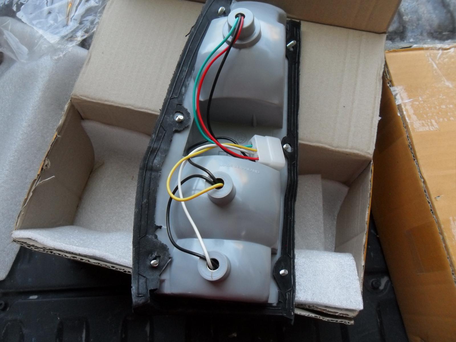

They showed up just now. To be honest they feel more substantial then what I have in there. I guess that is because they are new. I can see what you mean about weather Tortron. I'm not going to install them until I finish fixing up with the bed. here are pictures. The wires seem small but are secure. I only opened one.
Attachment 22916 Attachment 22917 Attachment 22918 Attachment 22919 Attachment 22920 Attachment 22921
Well to install the tail lights I had to bang in that middle piece of metal that goes across the hole and it is still iffy. One black wire came loose. I had to pull the one it paired to and the blade from the connector then solder them together and put the blade back into the connector. One backup light didn't want to work when I started to remove the screws it came on?

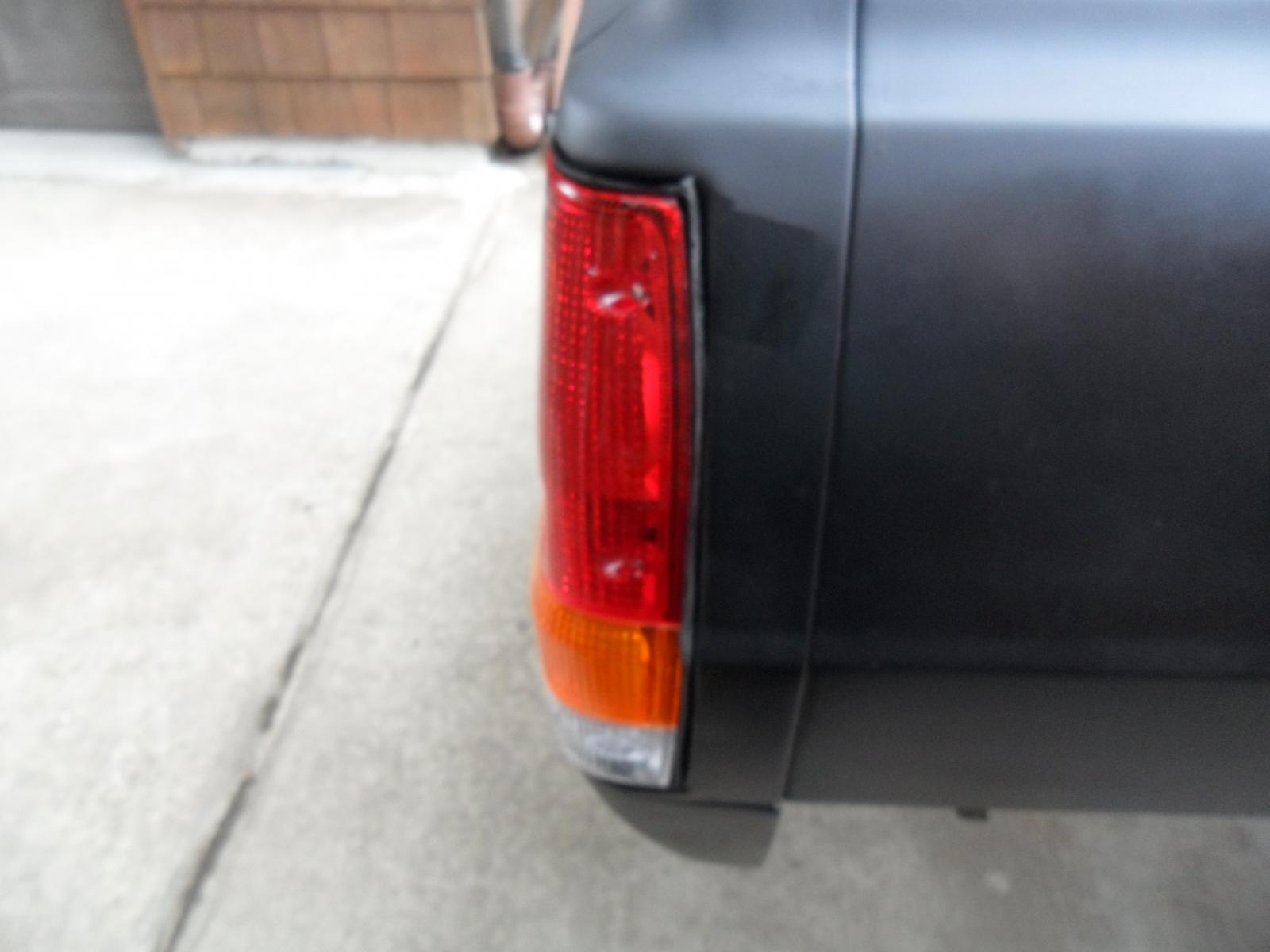

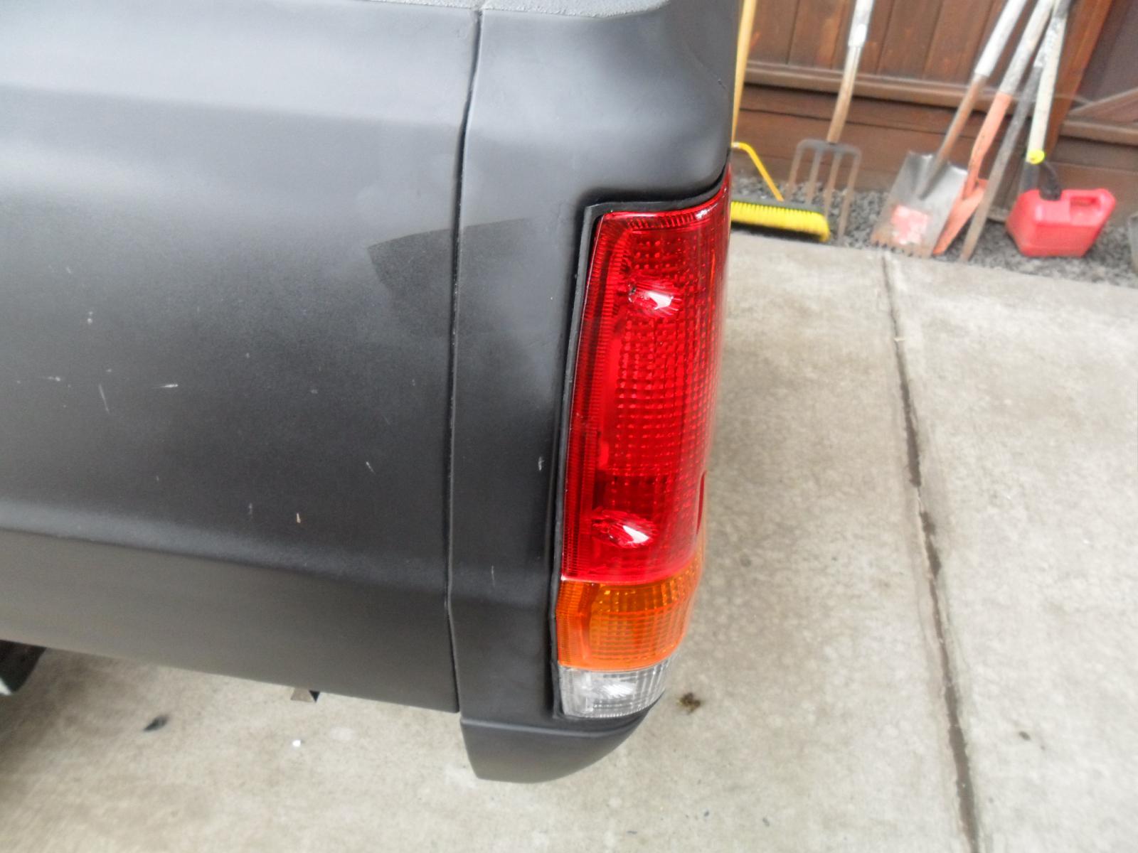

So I probably did not get a good deal. Here are some pics of the fit. I might contact the seller to inform them about the fit and the wires.
Attachment 23084 Attachment 23085 Attachment 23086
Yep the repro tail light lenses I bought have the same issues. The chamber dividers don't fit properly, the rubber seal around the casing doesn't seal that well onto the edges of the lenses and they sort of don't fit that well once assembled and installed. This is how they are. I have both the OEM assemblies and a pair of old repros and the repros bulb sockets and wiring are pretty ordinary quality wise. I am considering cutting up the repro lights and modifying them to run LED panels in them (I'd feel bad about butchering OEM's unless they were already busted up)
I sent a negative feedback mentioned the bad fit. I may go ahead and start messaging them about this as they seemed genuinely interested in having a good interaction with me maybe they will care and do something to correct the manufacturing problems. I suspect their molds are old or built based on something other than OE models or figures however that is done. I had to trim the tab for the U nut in one corner But they look nice from a distance :)
They're legal so at least they'll keep the LEO's off you. These repros have been around for decades and haven't changed. I have worked in injection molding and in all honesty it wouldn't have taken much to rectify the dies to improve fitment, the lens thickness and the added bonus of the improvement of plastics would've made these a much better quality product all round. I'd pay 50% more for a part that mounts like factory OEM and has UV stable polycarbonate lenses. Problem is - market. It's a lot to invest for such a small demand :shakehead:
