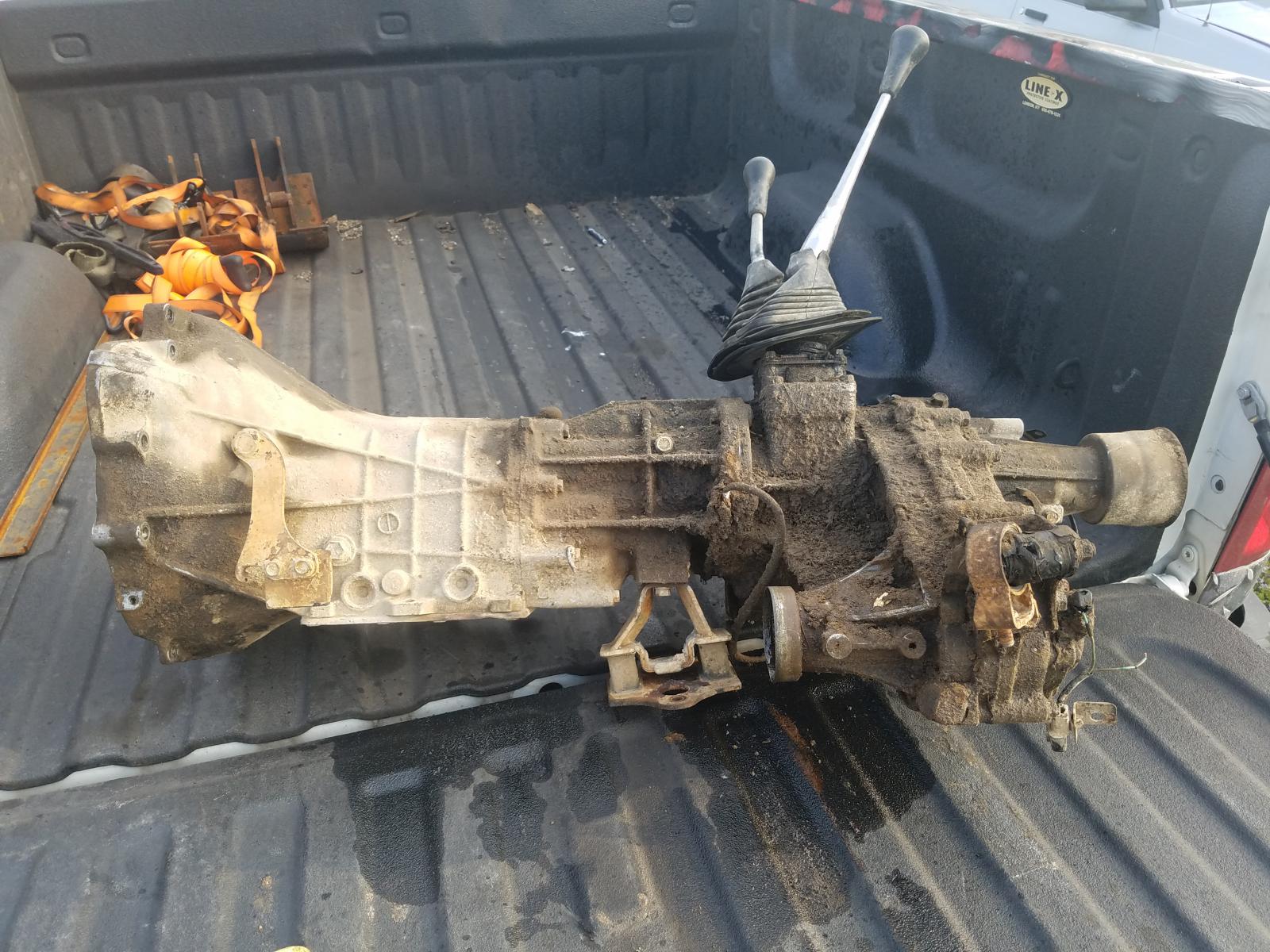

2 Attachment(s)

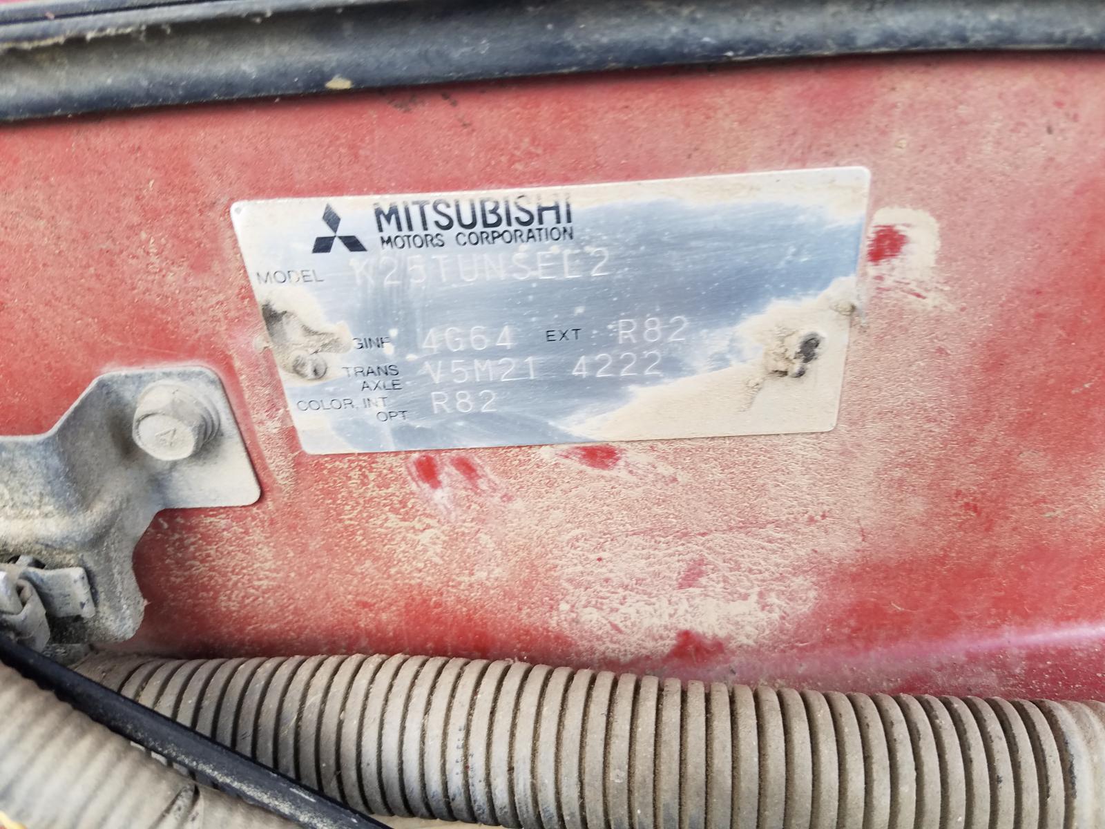

I'm swapping transmission and t case the donor truck tag said v5m21 and it had a 2.4 4cylinder.
Attachment 22308
Attachment 22309
That’s not any V5MT1 that I’ve ever seen.
https://imgur.com/a/TzLnpoB
V5M21 is what the tag on the firewall said. Not V5MT1. Anyhow this transmission has fit so far I'll find out more when I go to install driveshafts. Really just wondering if the 4th sensor the one called called a pulse generator will have any effect mj pt being hooked up. It looks to me that it reads like a speed sensor.
Anyone know the spline count for the rear out put shaft on the transfer case? Cant get them to line line up. It the last thing to put it back together other than filling it with oil.
I ran into an issue when trying to put an 89' transmission in my 87', i realized that the 89' had a slightly larger slip yoke than my 87' had. could be that the V5M21 you have uses this later style slip yoke? im not sure what its spline count was though.
