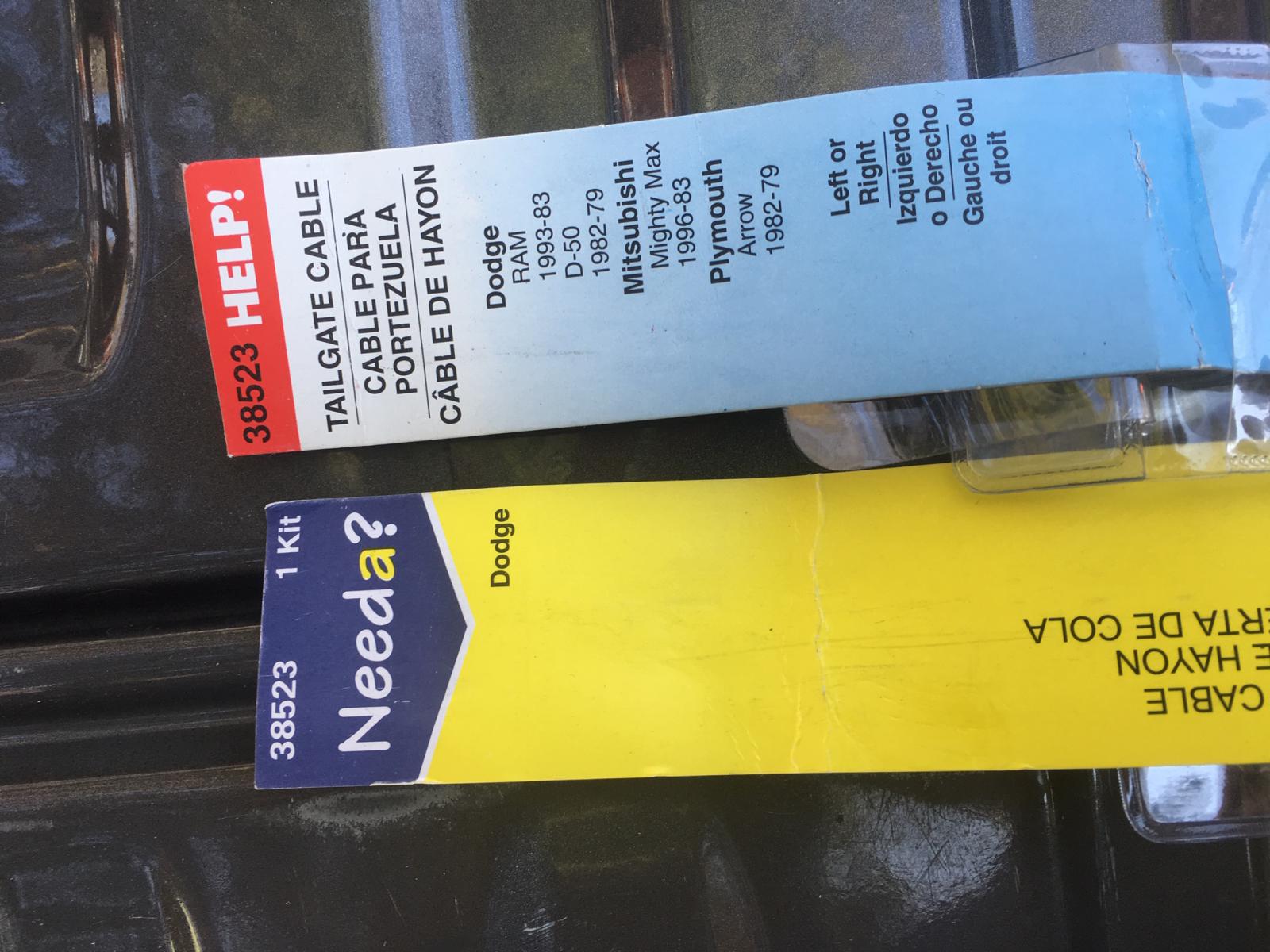

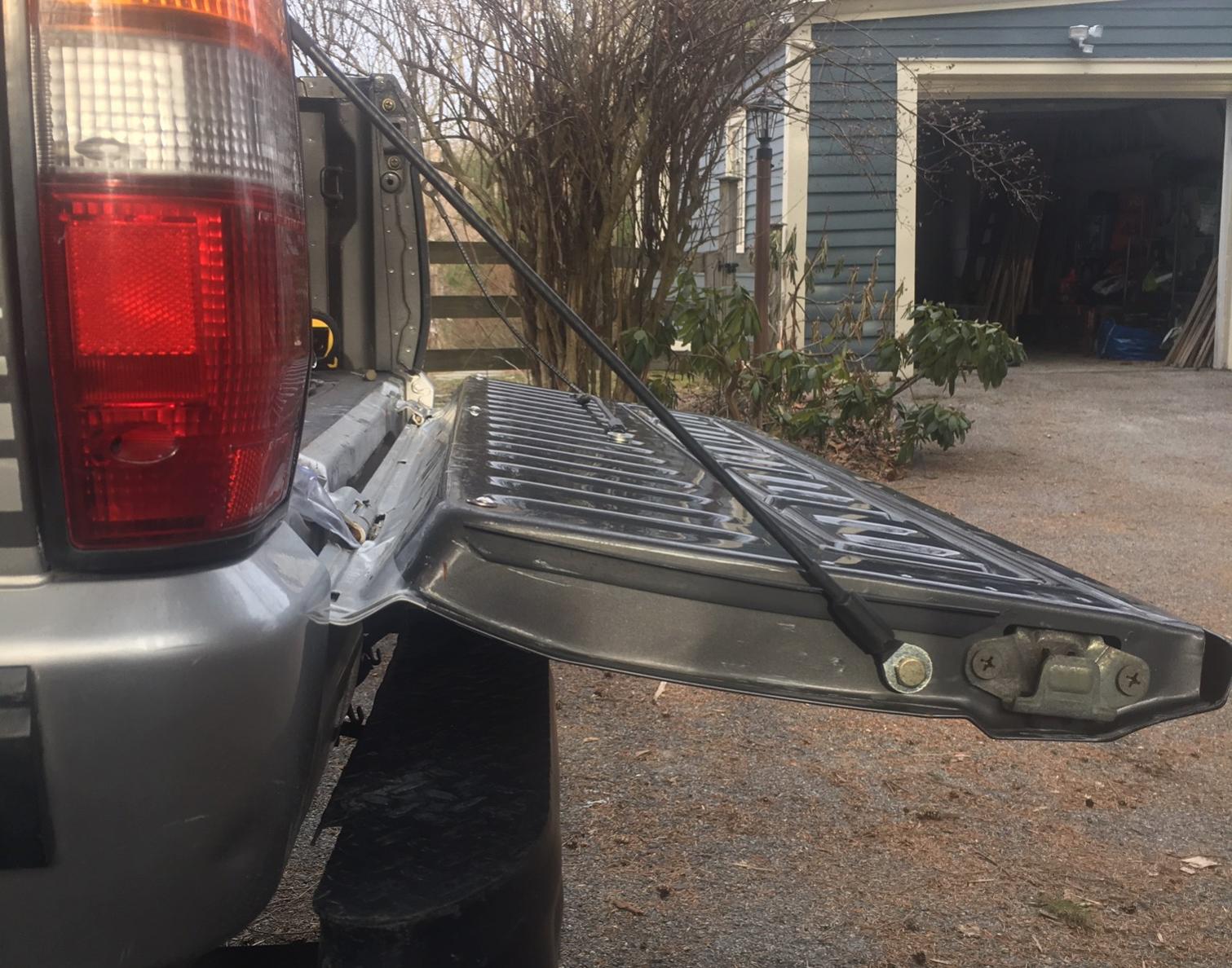

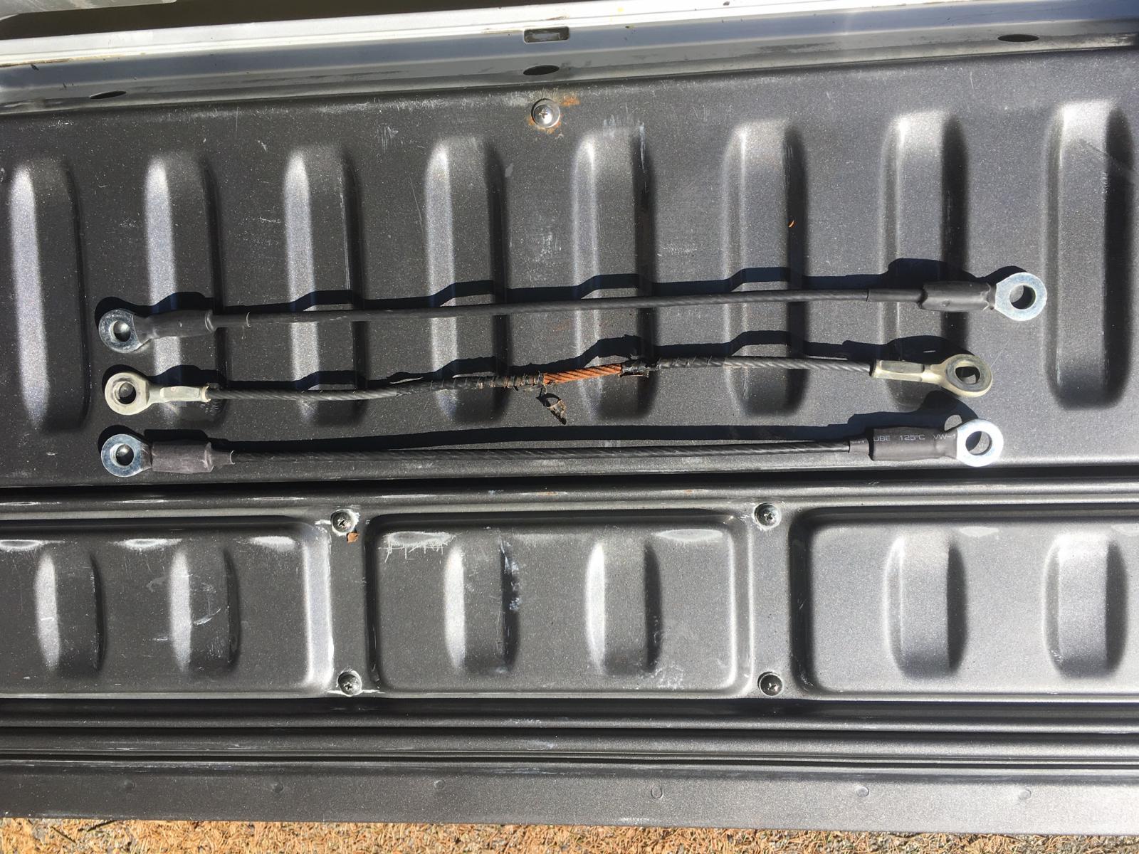

I need new cables as the original ones are not in great shape. I ordered the cables that are supposedly specific for this '87 truck from RockAuto, but they are the wrong size. They are 1" too long, and when installed the tailgate slopes down at a noticeable angle.

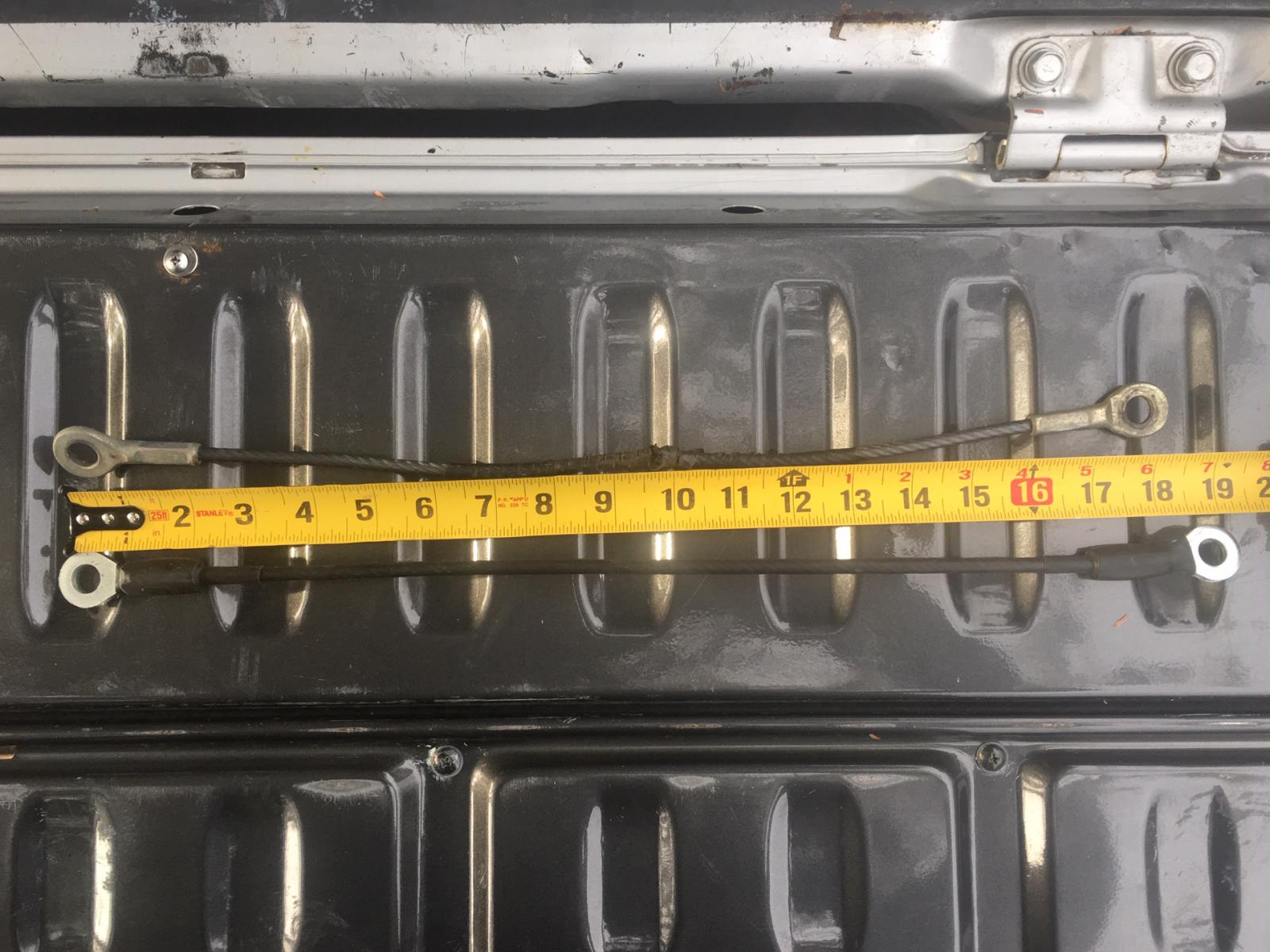

The original cable is 18 1/4"
Attachment 22196Attachment 22197
The part on RockAuto is Needa 38523, which is available in other sites as well and matched to this truck, is the wrong size.
