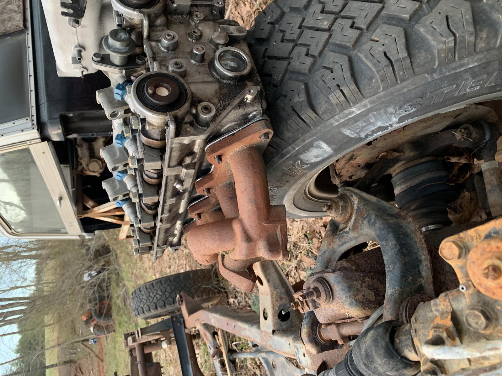

Going to put this 2g head on a mighty max bottom end. And that’s a Hyundai intake. Welded the injectors wholes up and machined back true. Hopefully it’ll work.
Excellent stuff. What Hyundai did you get the intake from? I thought it was the 2.4 Kia Optima intake that faced the right way for a RWD 2G conversion...
I have no idea what Hyundai it came off. I was at pull apart and seen it was a 4g63 engine and seen the intake was rolled to the bottom and backwards from other 4g63 intake and was like that will work. Lol. I just go by pull a part and look every once in a while and see what I can find and learn.

Heck yeah. It’s the best way to find out stuff that people have never tried or thought about. But I’ve got so much going on that I don’t know when I’ll get to try it out. Got a 4d55 in a two wheel drive 1990 d50 and going to get a conquest engine this weekend. I’ll tell you a way to find out if the Evo manifold will work. Buy an Evo gasket and a gasket for your j2 and match them up. That’s how I found out this head and intake would bolt up. What litter is your j2?

Hyundai / Kia and Mitsu designed the 4g6X and other motors together as their world motor series. Just packaging differences and different names - if it looks the same it most likely will fit...
