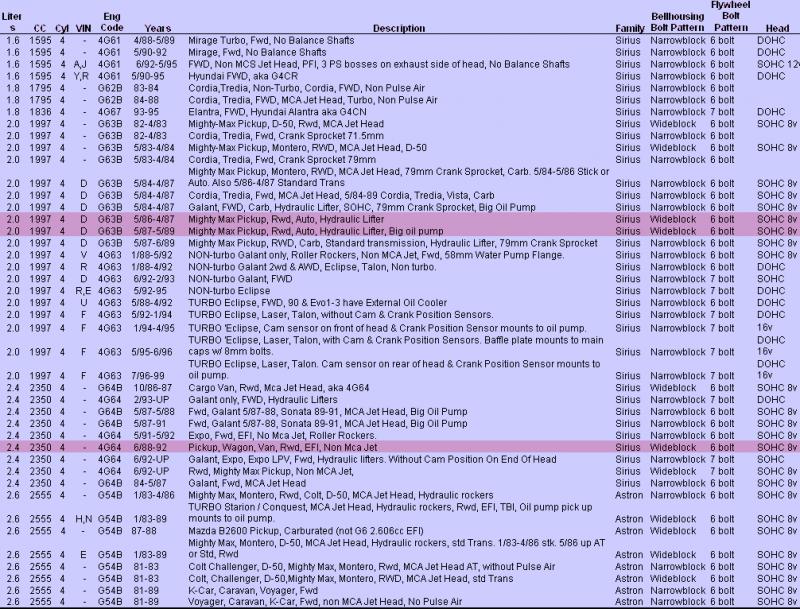

Have a 1984 Ram 50 (LO26) 4spd with a 2.0 (G63B), have an opportunity to acquire a 1994 Mighty Max with a 2.3 motor and auto trans, the motor is out of the truck and is fresh from the machine shop (rebuilt), I want to swap the freshly rebuilt motor 2.3 with my 2.0.
I need to know if the bolt pattern from the 2.0's bellhousing is the same as the 2.3's bolt pattern on the rear of the block, so as I may retain my 4spd (pretty much the best theft deterrent out there...a manual transmission) can someone answer this ?, any and all assistance would be greatly appreciated.
