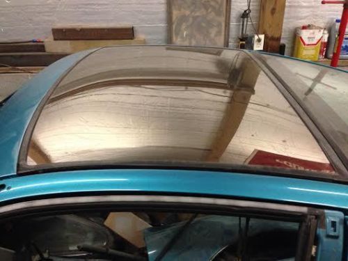

1 Attachment(s)
Glass roof option???
I have been considering fabing up a glass roof option for the MM.

Luckily I caught a buddy about to dump a 98ish honda prelude after plucking out the H22. Glass roof was ideal
Measurements checked out & electrics.... so I 'surgically' removed the honda sunroof. Free is always good

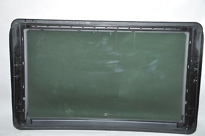

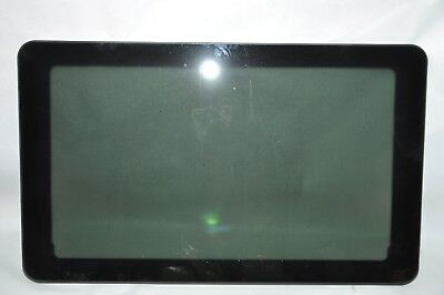

2 Attachment(s)
https://www.ebay.com/itm/2004-Merced...ac6f%7Ciid%3A1
Rply all ::'Thought about something like this??? As long. As it fits. I haven't taken any measurements as of yet.
