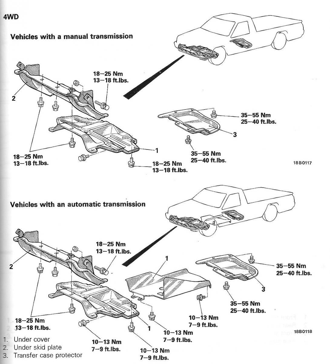

I'm guessing it shouldn't be too hard to have one made, at the end of the day is just a piece of bended metal. Any ideas on how to go about this? I haven't been able to find a good photo or diagram of one to figure out the shape, size, or the attachment points.
Has anyone done this already? Or, any ideas where I can find an existing one?
