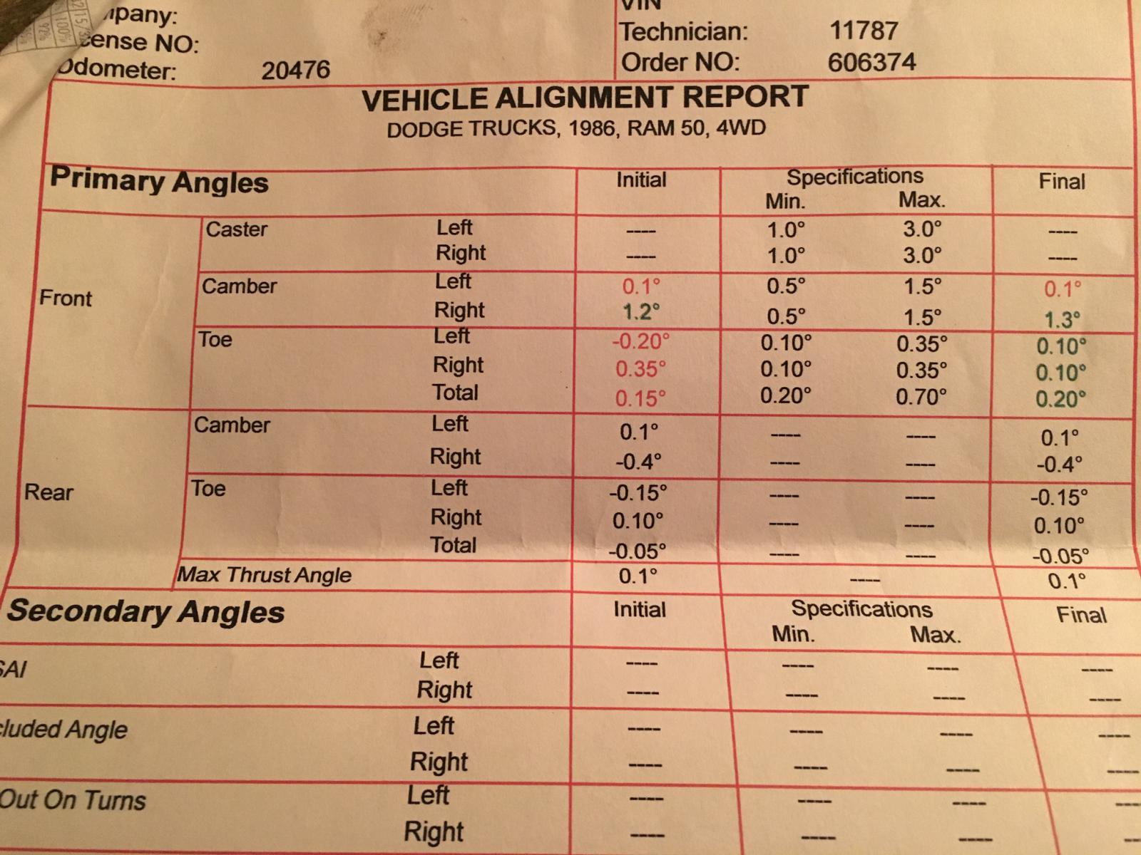

My steering wheel is a little off-center when going straight. If I dont pull it slightly to the left (about 10 degrees), the truck will vear to the right. I went and got an alignment hoping it would fix the issue, but it didn't. The truck still wants to go to the right, and I still have to pull on the wheel to keep it straight.
Here's the alignment report-
Attachment 21835
From what I can tell, the camber and caster didn't change at all, and the toe only changed to the lowest end of the acceptable range.
The guy at Mavis told me that there's not much adjustment they could do in a vehicle this old (and that there's no caster adjustment possible period), unless I rebuilt something or other.
To be honest, I'm not really that surprised that the adjustment is limited, being how old the truck is (it's an '87 btw, not '86 like the report says), but I feel that he should've told me that BEFORE they did the work, not after.... but whatever.
So I have a few questions:
1. Is it true that caster cannot be adjusted on this truck?
2. Does it seem reasonable that camber was not possible to adjust on the left front wheel? Keep in mind that this truck did have a front end collision that was strong enough to destroy the tire...
3. Is the toe adjustment acceptable?
4. Should I even bother going back there and asking them to do better?
