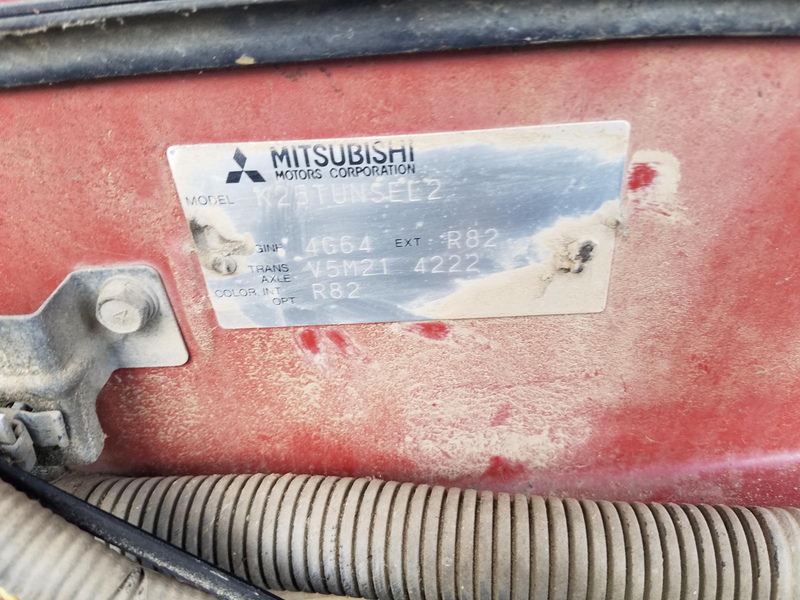

I'm looking to swap transmissions mine is a km145 it has some issues. I found an 89 mm it has a different eng trans combo. Main question is will they interchange w/o much hassle. See pic for donor vehicle info.

Damn - that is the good tranny and has 4.22 gears, and probably a locker. That tranny is a great changeout for the km145 - grab the whole truck if you can...
Do what??? Did I stumble on something? Is there any way to verify what it came with? I'd buy the whole truck if it has a locker and lower gears. Is that a lower gear in the transfer case or axles.
the v5m21 is the better tranny, and the 4222 is the lower gearset. usually the 4.22 gears come with LSD in the trucks.
Interesting. I went looking for a trans and possibly torsion bars. I may leave with whole truck. Is it a simple swap for the transmission? Driveline the same length? Mounts the same?

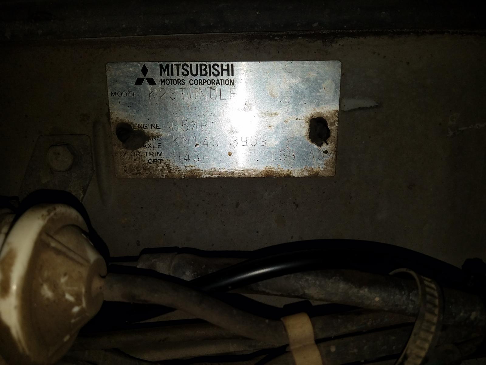

Attachment 21478
And that transmission will bolt up to my g54b? Wasn't ready to get into a whole drivetrain swap yet but I would definitely take the axles for a swap later on. Lower gears would make this thing even more of a tank.
if it is on a 2.4 yes, if on a 3.0 v6, not without a bellhousing swap.
