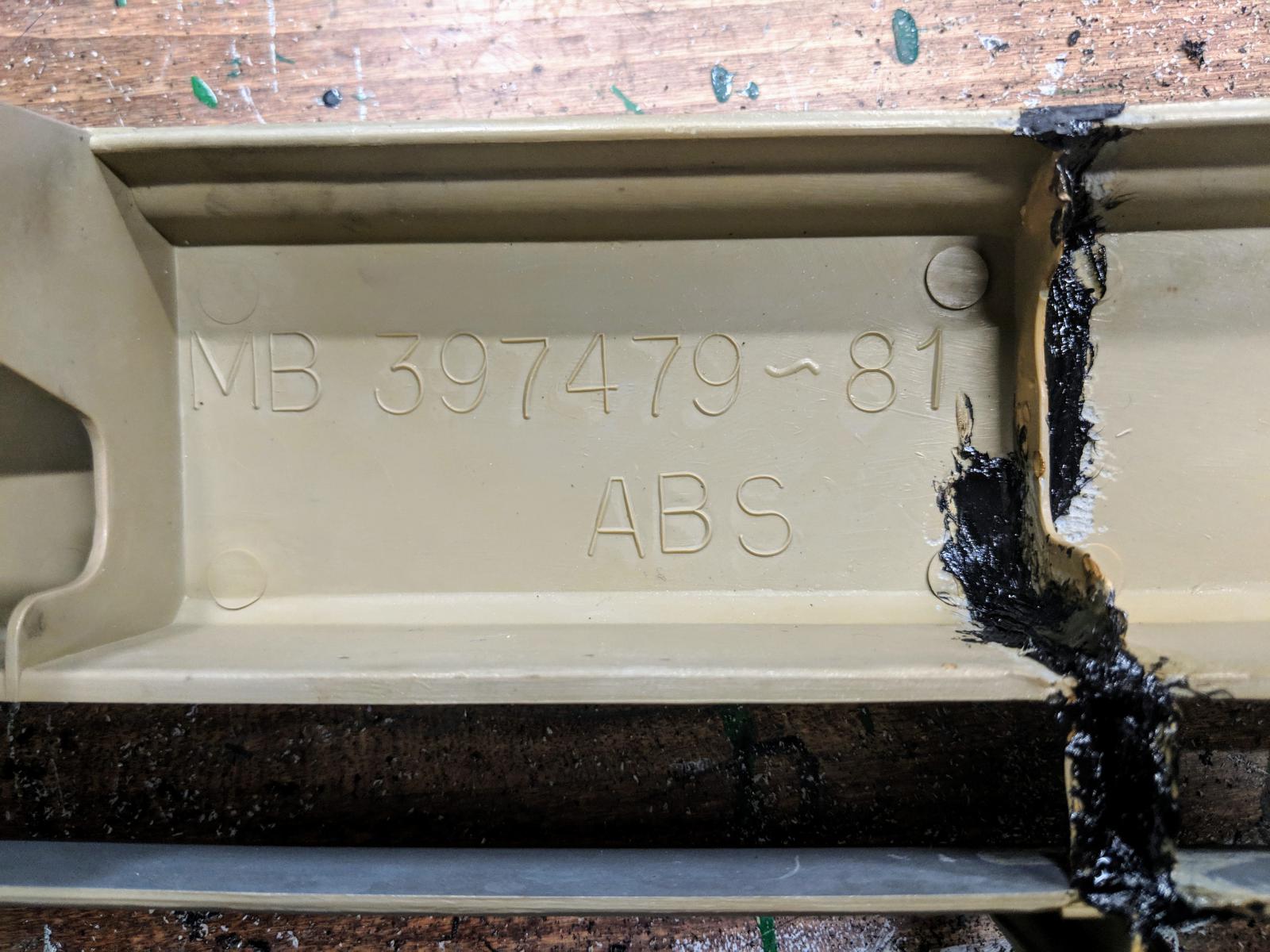

Repairing broken grille with pluming pipe

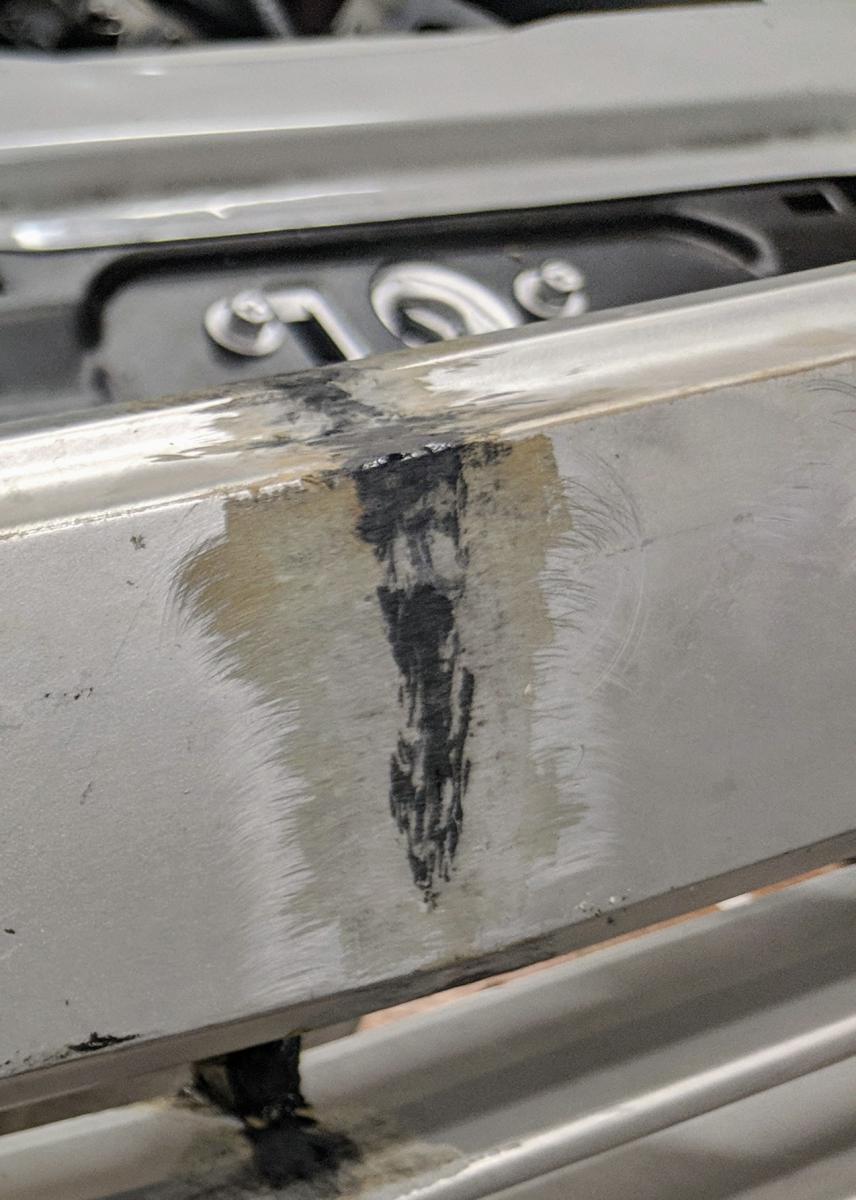

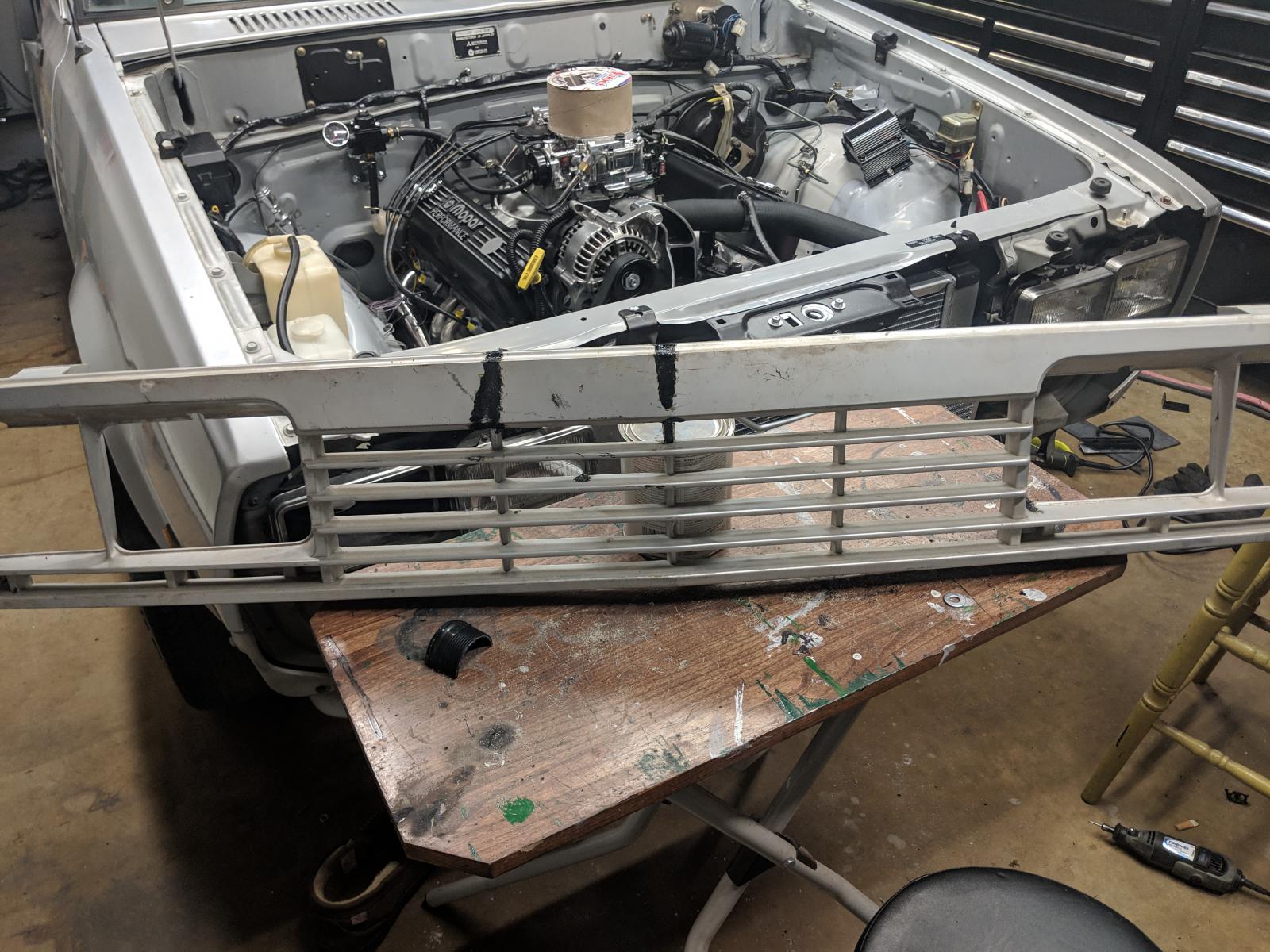

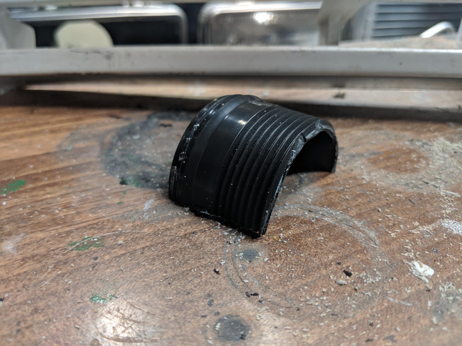

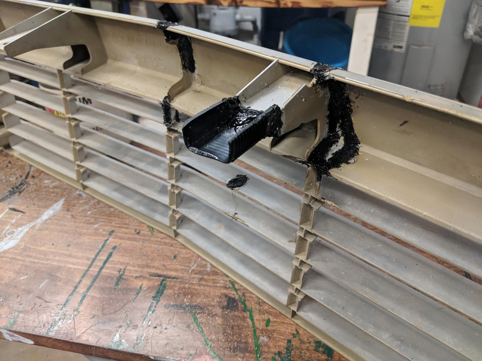

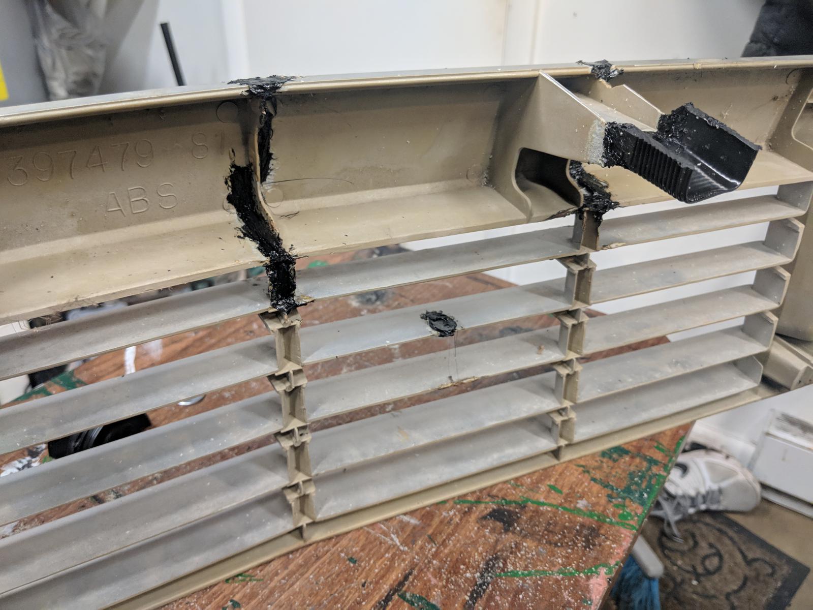

I did some experimenting and found that black ABS pipe can be welded to the first gen ABS grilles. (I don't know if 2nd gen grilles are made of ABS) I used a soldering gun for the welding and my heat gun to do the shaping. There are plenty of websites and videos on welding plastic with this approach. With some trimming, sanding and body filler it should look good. I figured I would give it a try after having no luck finding a replacement grille.
Attachment 21433
