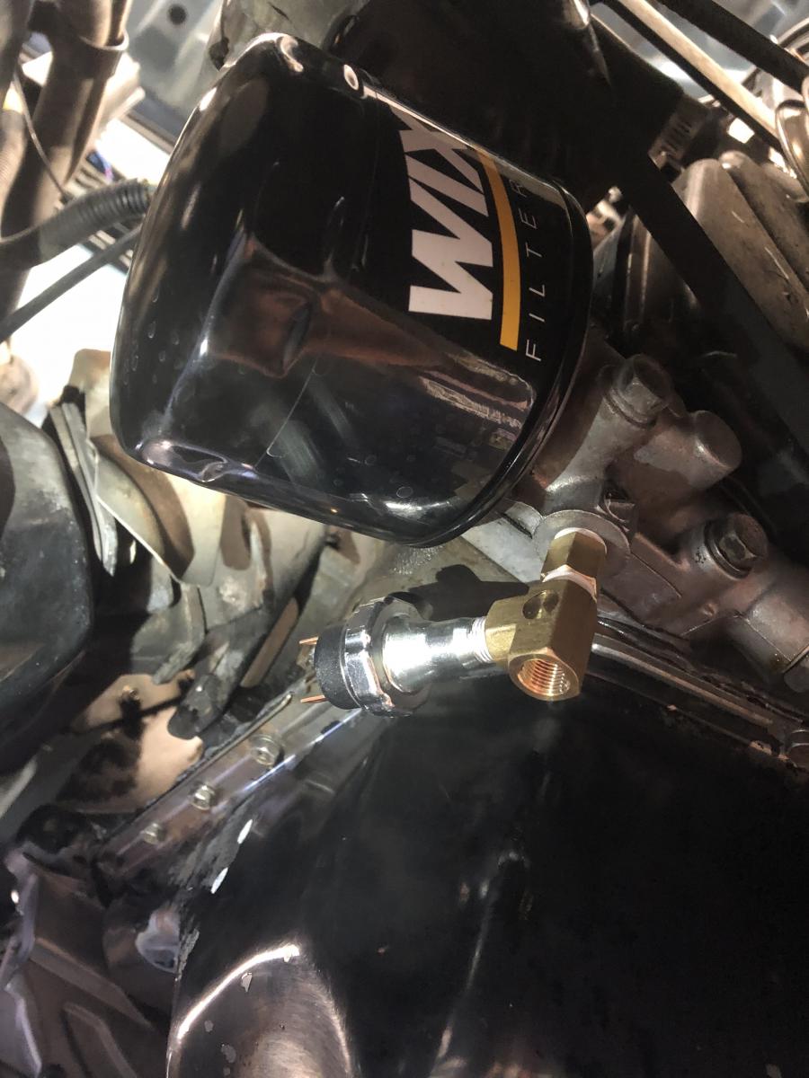

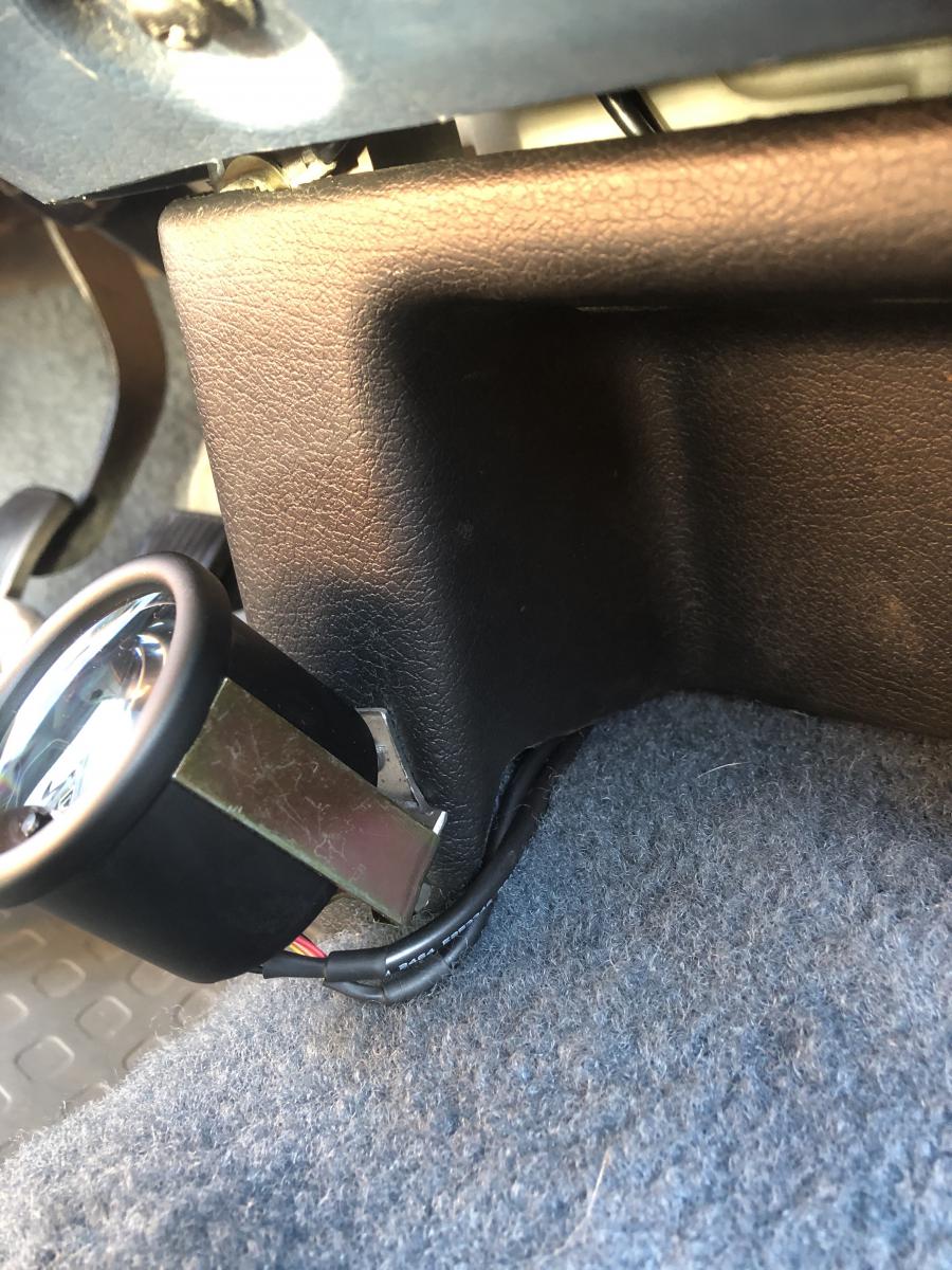

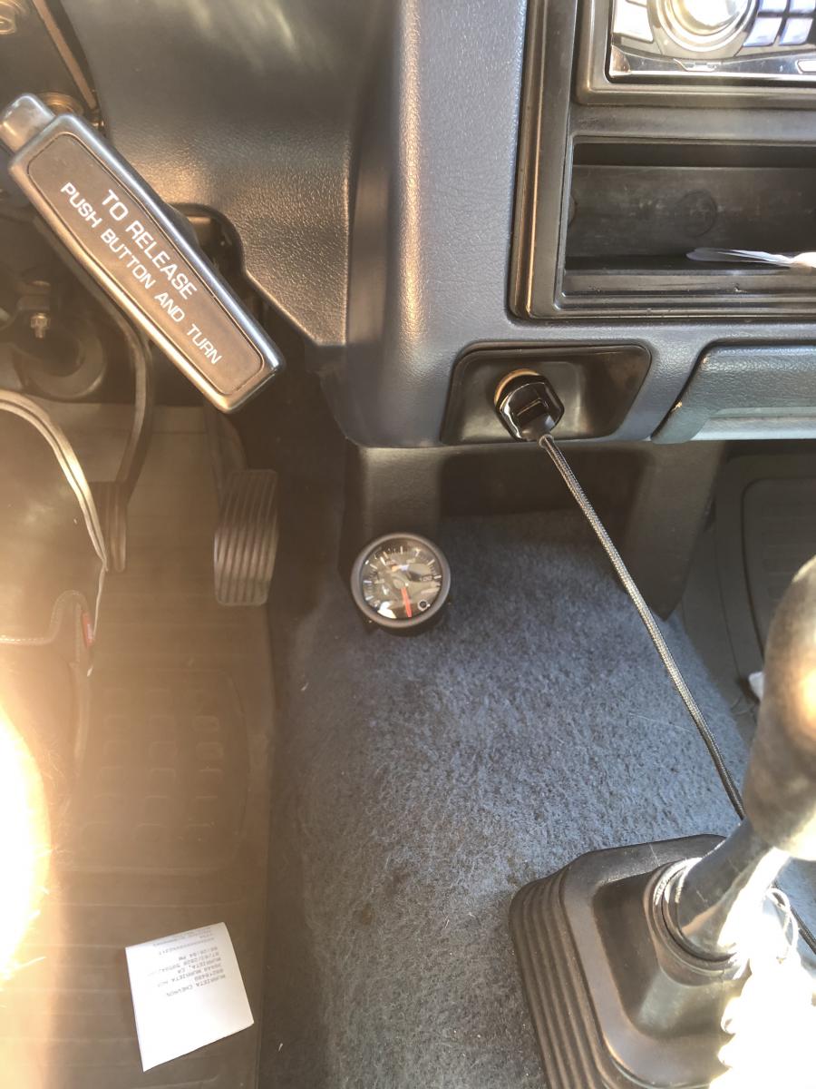

I just finished up installing an electric oil pressure gauge in my 89 G63B. You do need an adapter and a tee (the tee for an oil pressure valve for electric fuel pump). for my particular gauge, it required me to wire it up to constant 12v, ignition 12v, headlight switch for the dimmer, and ground. Then the other plug just came straight off the oil pressure sunder supplied with the kit. I made a little mount that just screwed into the lower console area near the floor and it all works out pretty sweet. The gauge has a number of different colors that you can choose, and as I mentioned earlier dims when the headlights are on.
The picture of the adapter and tee doesn't have the sender installed obviously, but with the sender screwed in and the wire plugged into that, it fits perfectly and clears the skid plate with about 1/4. Hope this helps someone. :thumbup:
^ I bought a bunch of those gauges for my Hung Dog wagon (A/F, volt and vac sans 'Glow Shift' logo) - haven't installed them yet but that last pic will motivate me :grin: And thanks for posting up the threaded adapters for the oil pressure senders.
Hopefully this will make it a little easier for someone to find the right stuff!
also, once engine is warmed up, oil pressure is ~20psi at idle and ~70-80psi at 65-75 mph. The gauge seems to be pretty accurate and very responsive to throttle pedal pressure :thumbup:
