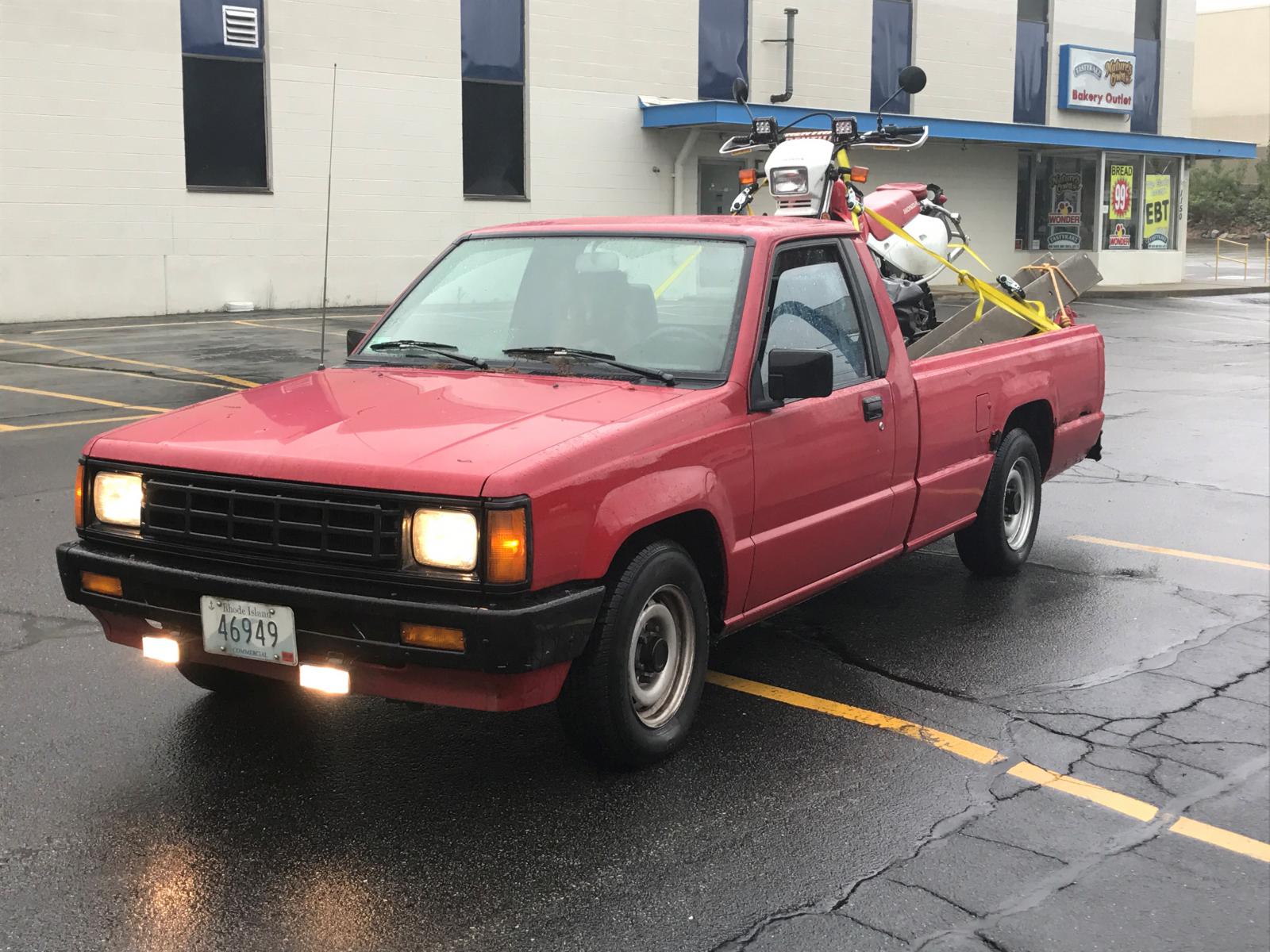

Attachment 21149I bought a harbor freight motorcycle wheel chock and just set it in the middle of the bed. The corrugated floor keeps it from sliding around. I used the 4 tie down points in the corner of the bed with some ratchet straps. The weight should be of no concern, but i could definitely feel the increased wind resistance at 75mph with my 2.6 auto. I probably had close to 1000lbs in the truck total. Lots of heavy metal bits packed in around the bike that you cant see.
