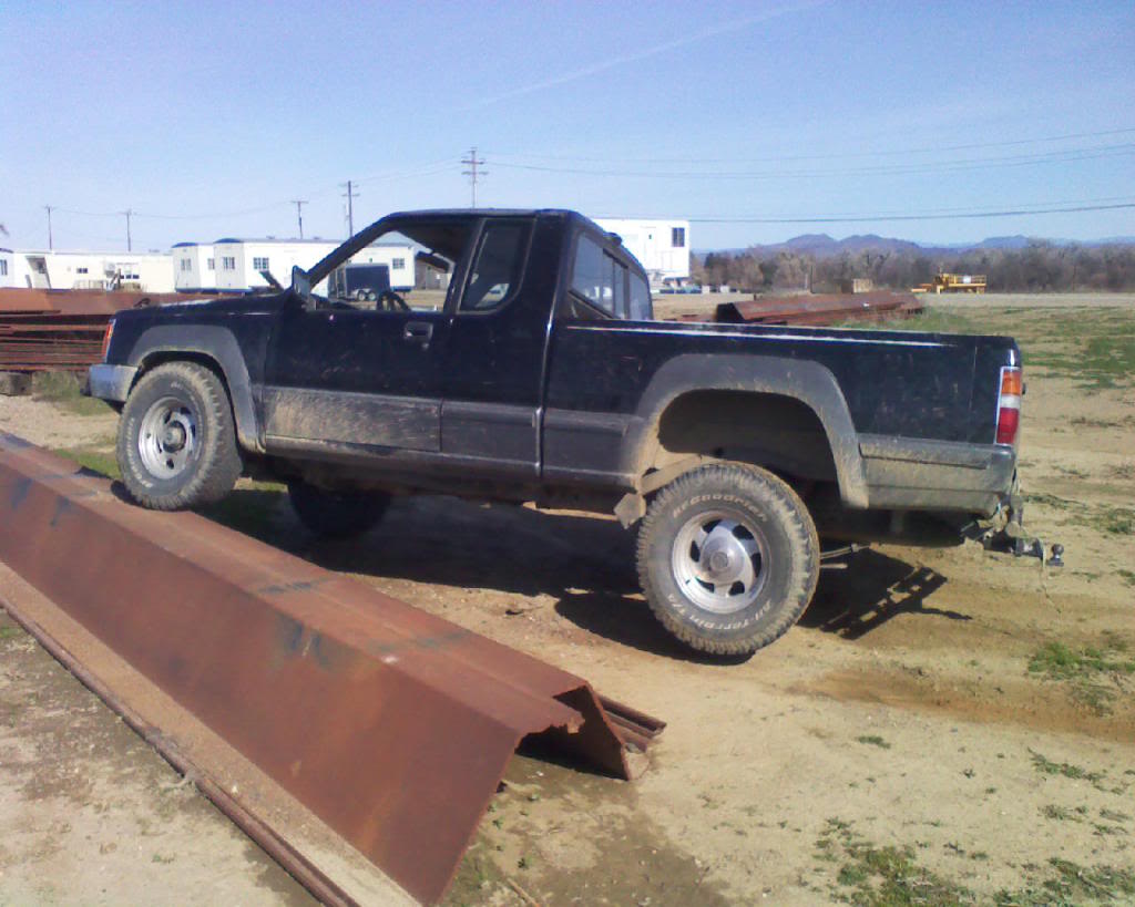

31x10.5s 'fit' the 4x4 models, but rub in the front wheel well. 33's will also 'fit', but rub everything. 35's 'fit', but will not let you steer for lack of any wheel well space. 31s on truck in this picAttachment 21160
3 inch lift will clear 31s - may have to trim the inner wheel well in the front for clearance
