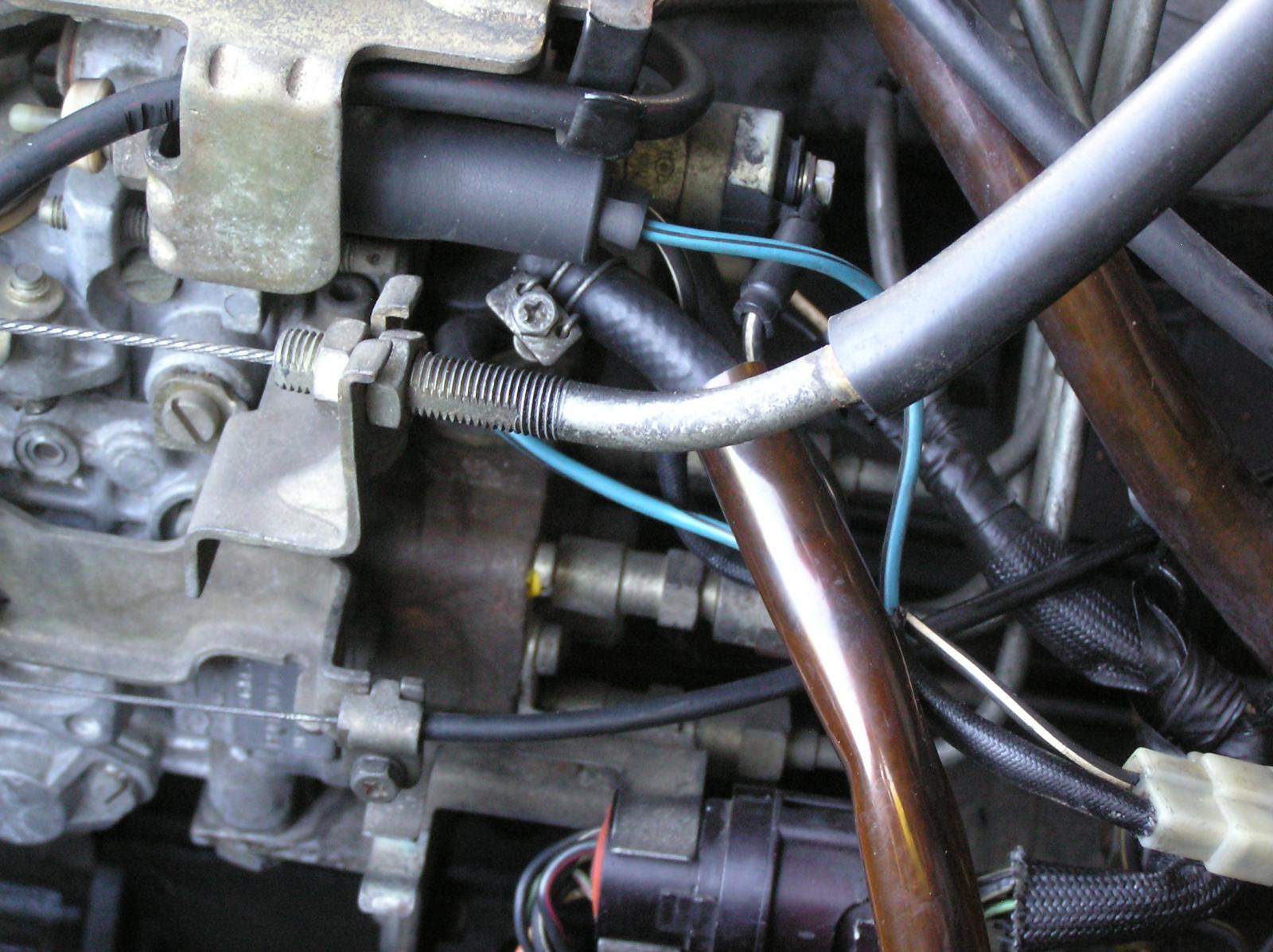

I've looked for information about the pump but only found general information. For instance, there is a fuel shutoff valve that is supplied 12v when operating but removed when key is turned off and fuel flow is stopped. A Bosch video on Youtube shows the fuel shutoff is near the fuel inlet and I found a few wires in that area. I found what I think is the fuel shutoff and wire and the 12v is present when the problem occurs i.e. it still won't start.
