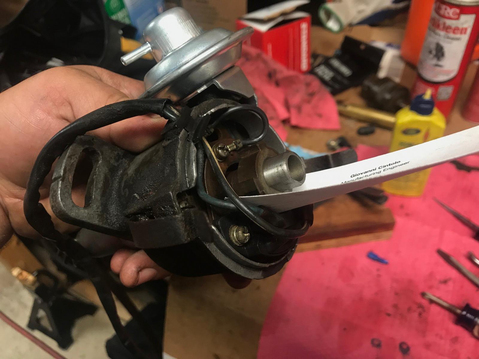

Another question, is there a specification for end play, as well as rotational play for the distributor shaft? I've got an AFR that wanders under certain conditions and was getting some pinging as well. ( I got the pinging to stop by unhooking the vacuum advance on the side of the road). I'm pretty sure it is an ignition timing problem. When I popped the distributor cap off and looked at the shaft, I've probably got about .060" of end play, and a few degrees or rotational play. Subjectively, it feels sloppy to me. It started a while ago, and when I replaced my junk timing chains a few weeks ago it got better but didn't go away. I think maybe that chain slapping around loading and unloading the distributor gears might have put some wear in them. That and 240K miles of driving.
