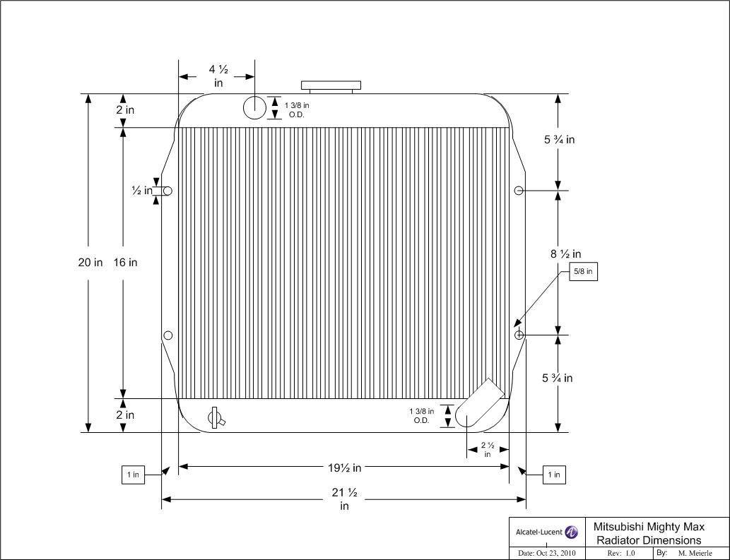

Hi and welcome to mightyram. Is it worth considering using an all alloy radiator from ebay? They are generally cheaper and more efficient than the original radiators. You have the old radiator to use as a guide.
My radiator for my 91 Ram 4x4 V6 was bad as well when I picked it up. Tried a couple online sites but none of them actually had the radiator I needed. Ended up finding an almost new one in a 250k mile might max V6. Good luck!
as mentioned, using your oem radiator dimensions, in/outlets size & position... u could find a plastic/aluminum substitute
Usually a 'little tweaking' to get it to fit/installed.
I do that with all my swaps.... normally maximizing the size (also must clear AC & intecooler plumbing)
Not paid over $95 for one yet. Worked fine
saw a turbo max on starquestclub with a perfect fit plastic/alum radiator from some other oem application
I asked the source, but didn't remember the thread, to follow up on the reply. So we know they exist
dunno about copper radiators lesser efficiecy or performance.... but they are considerably heavier & more costly
Dimensioned Drawing Attachment 20857

I ended up installing an aftermarket Montero radiator from the same years. Took it to the mechanic and he had to modify the mounts to install and change the lower hose to a Montero radiator hose. So far working great... well see.
glad u got it sorted out. Hose barb positioning on the V6 radiator very different than the 4cyl version
