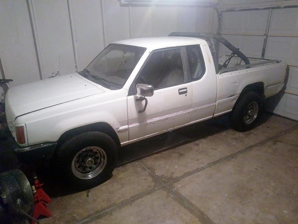

Okay, that last bit about getting rid of it was a bit harsh! Posting a pic. It's an Arizona truck so it has no rust, even the leaky parts are ridiculously clean. Just keep reading so much about mods and stuff people are doing, I'm not sure what to do. If I were to start a rebuild from ground up, is the 2.6L with flat pistons, better exhaust, non-jet heads, and weber 38 a good build?

Hi and welcome to mightyram. Don't worry about the whole "I'm gonna get rid of this thing and buy a Yota" jibe, you'll see the light soon enough. The 2.6's strongest point is torque. Rip all the smog junk off it, add headers, a decent exhaust and upgrade to the 38 DGES and you're on the path to making good, useable HP and torque. There's a ton of helpful info on sorting out the 4x4 - a number of members have similar issues with their transmissions being locked out of low/high range. Try driving it in reverse a few feet, get it in neutral and then attempt to change gear ranges before selecting 1st. The transfer case might (more likely will) need a flush out and some fresh blood put through it.

I agree with that, these are awesome. All of the old Mistu based trucks and SUV's. From what I can tell, I need a lot, the interior is in good shape, seats are gone, but that's nothing. I really like the Montero V6 swap with the dash, but that's more than I want to do.
