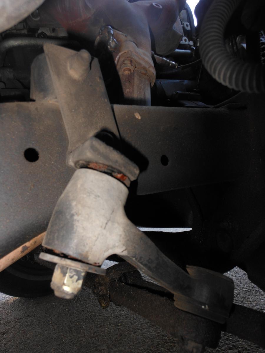

Issue at hand: see attached photo.
Attachment 20351
Not sure what this part is called (???). Problem: just today, a light metal on metal sound showed up with any slight turning of the steering wheel in any direction. It's come from the rear (large) "spindle" in the part... can see it wobble when steering wheel turned and hear sound there as well.

Yup thats the idler arm assembly
You can get new ones (confirm year of truck when ordering) and you can get bush replacement kits to repair
If the tie rod joint is ok on it you can get away with installing new bushes in it. Otherwise you're up for a complete assembly. As long as nothing is bent (check the shaft the idler arm is mounted to for wear/damage).
Thanks guys. Think I'll play it safe and replace entire part.
