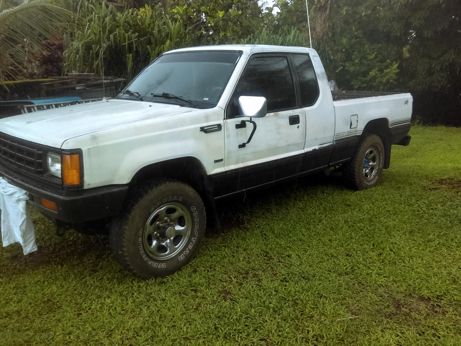

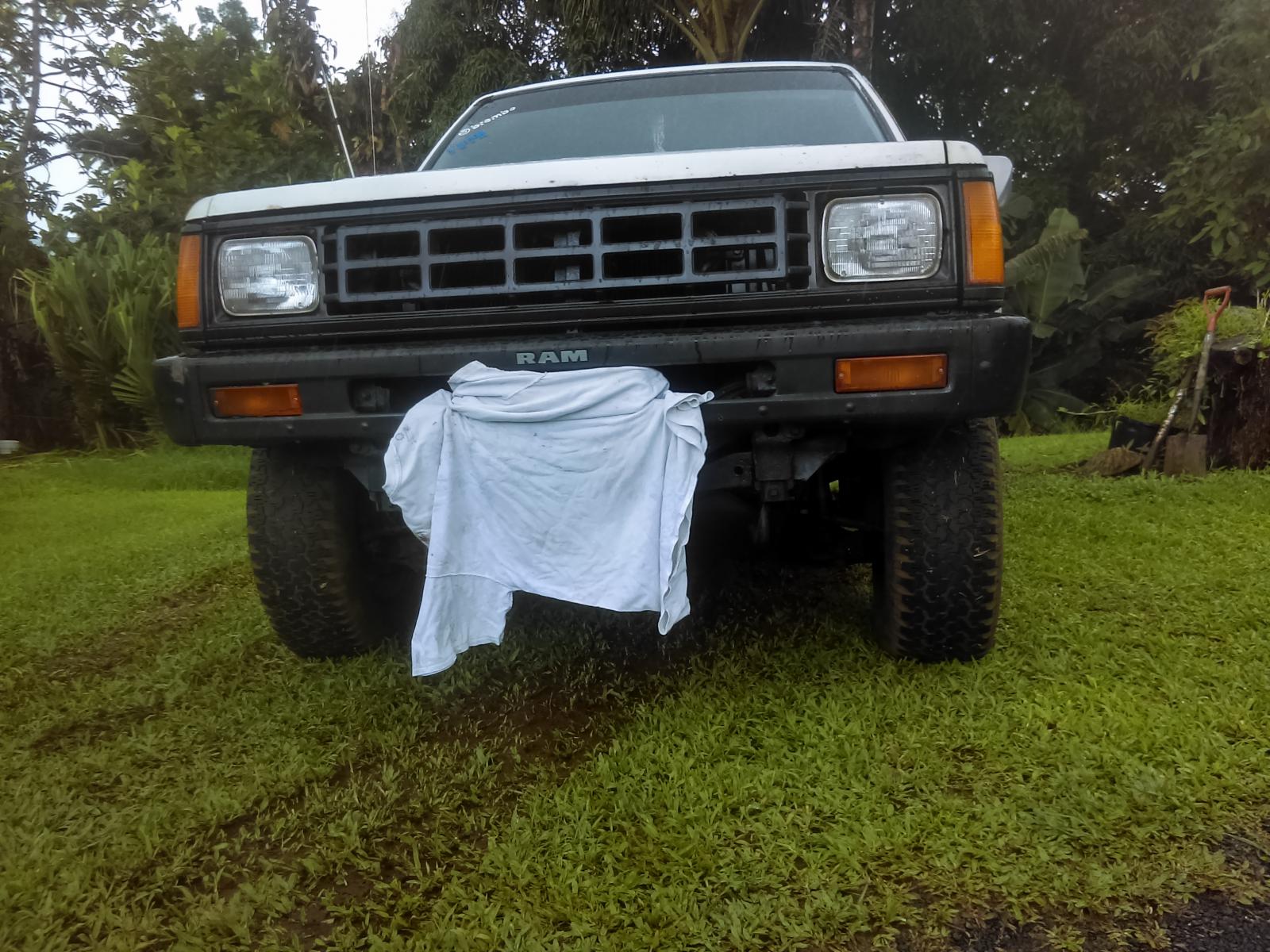

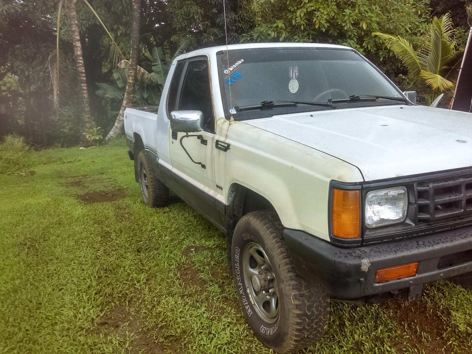

Attachment 20323Attachment 20324Attachment 20325
