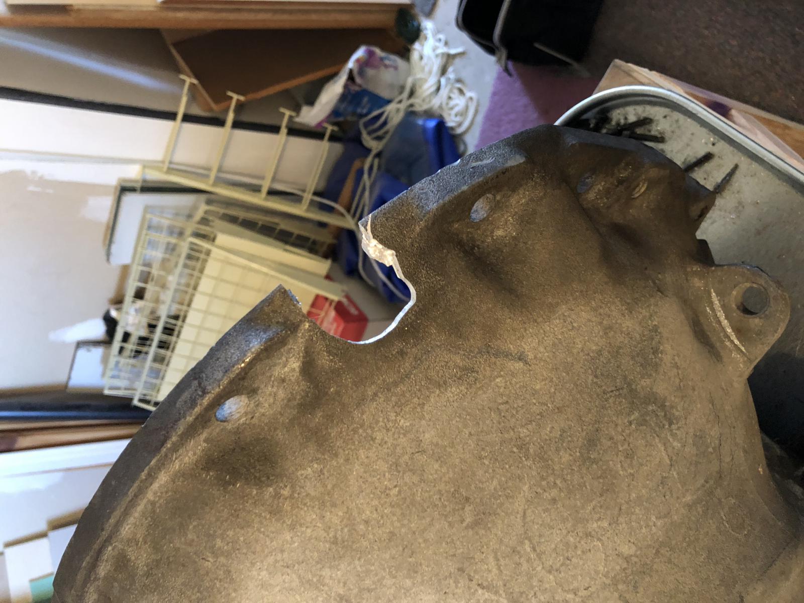

So the first thing I needed to do after acquiring the truck was to get a motor and transmission. After researching online, I decided to go with a magnum motor mated to a TorqueFlite a904 transmission. So I found a wrecked 97 ram 1500 with the 5.9 magnum engine locally and decided to buy a 904 on eBay. Funny story, the seller of the transmission dropped it off at UPS to have them package and then ship it, and the IDIOTS there just decided to throw it in a cardboard box and call it good. When the tranny arrived, the box was completely mangled and the bell housing was broken. UPS ended up reimbursing me for that so I guess it was alright? I found another one locally that was old and rusted out but had a good bell housing. I then spent the next 2 months swapping the parts over from the broken tranny to the good one, and replacing worn out stuff. Next up was to notch the tranny to fit the magnums crank sensor located on the back of the block (needed because I am using the fuel injection and ECM from the wrecked truck to run it).Attachment 20317
I just used a router to notch the tranny. Next up is getting the tranny in the truck so I can properly line up the engine. According to my research, using the 904 should allow me to bolt it straight in and not have to worry about custom driveshafts.

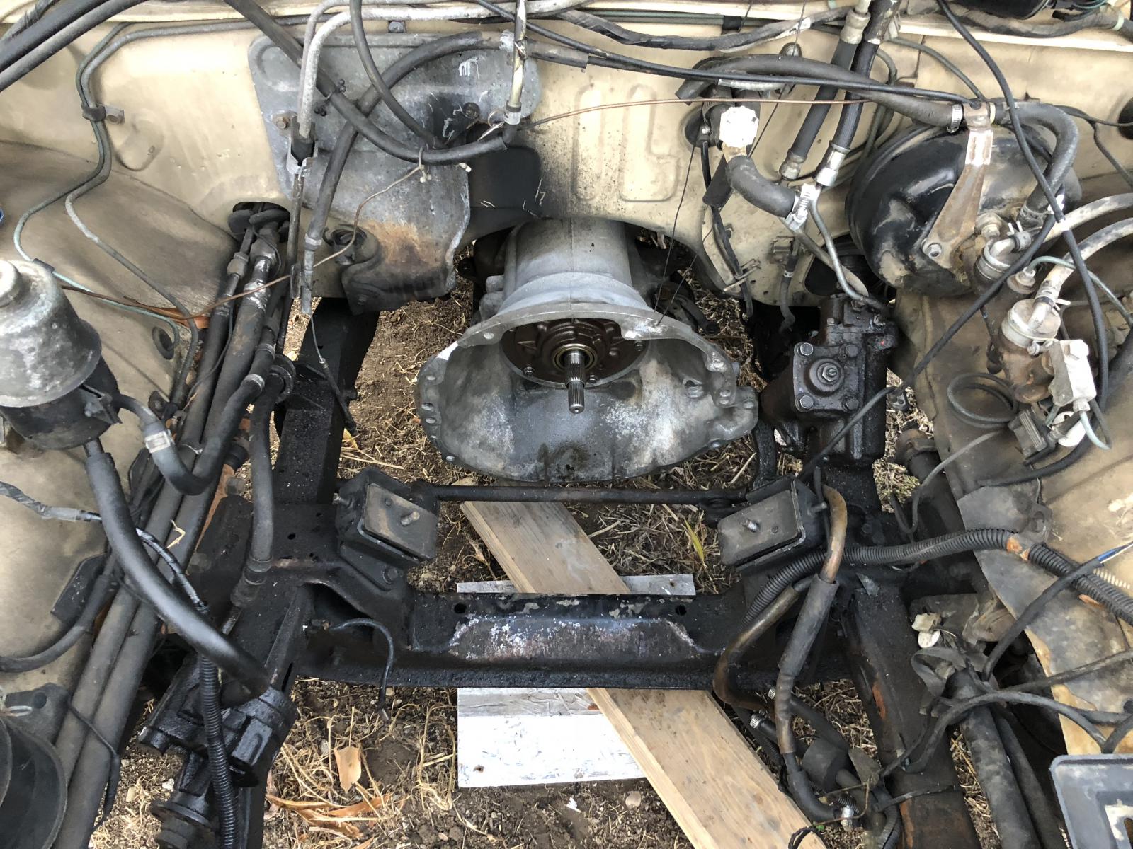

Attachment 20318
Heres the engine bay with the tranny in. This is where the truck currently sits. I have the engine pulled and ready to test fit to see what I need to start cutting so that will most likely be next.
This is my first time ever doing something like this, so I am very open to suggestions and tips if you have any.
