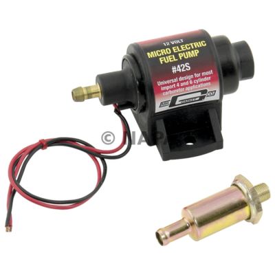

I've had this truck about two weeks now. PO threw a bunch of parts at it to try and make it run. What I found was he scrapped the old carb for a Weber swap replaced coil resistor icm cap rotor. And still couldn't get it to run right. Since I've had it I've removed the factory pump and replaced with an electronic pump And got the timing and plug wires lined out (it was 180 out and plug wires out of order). But still only get 15 mins of run time before it dies. Any help would be appreciated.
