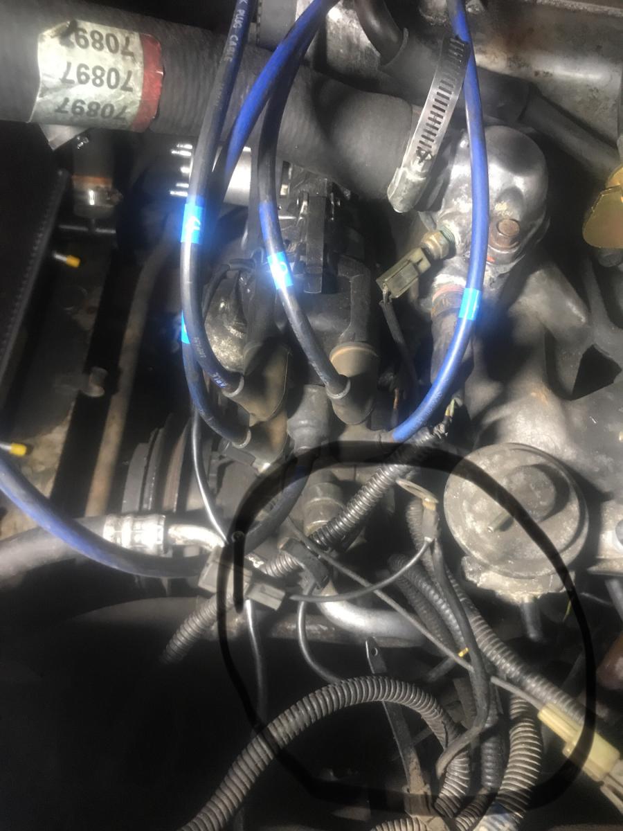

I don't have it hooked to anything. I have a DGV(Manual chock). Is the wire by it's self or is it with a bunch of other wires in a connector?
The wire is a single thick black wire with a white stripe and has a bullet type connector on it with a silicone sheath/insulator. If it's not hooked up to anything it should be floating in the vicinity of the intake manifold. If it's grounded or hooked up to something it shouldn't be you need to find it and insulate it. This should be the only thing you have changed electrically speaking when you ditched the Mikuni for the Weber.
Do you have a picture of it. Here is the only thing I found Attachment 20247
...any Gen 2 guys with the 2.0 engine wanna confirm where the fuel cut solenoid wire is located for the original Mikuni carb?
Anyone have a picture?
