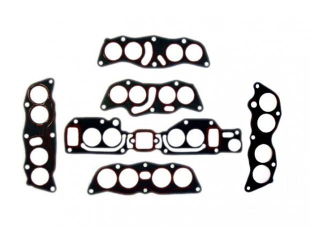

I just changed the gasket on my exhaust manifold, no sweat. I went and bought a set for the intake side and only one of the gaskets fits. The plate on my firewall says I have the 4G64 and when I look up the gasket kits they all look like the one I have, now I'm stuck. This is the kit I have, the gasket that fits is the one that goes between the manifold and the block. (The more square shaped one) I'm not even sure where all these other gaskets go. I only needed two. Tho one between the block and the manifold and the one between the manifold and the injection system. What's my next move?! Attachment 20136
There are different gaskets depending on what EGR system is used on the engine (and possibly turbo). Like most of these kits they try to cover a couple of different engine configurations. The smaller gaskets are the ones that go in the middle of the intake runner sections (plenum upper to manifold lower). Whatever gaskets you're not using either junk them or put them aside just in cast someone you know could use them
The gasket I need connects the upper to the lower manifold and it didn't come with the set I purchased. They're pretty close but not useable. My neighbor happened to stop by today and he also happened to have a sheet of gasket material laying around, it's a bit thicker than the actual gaskets from the kit but I don't see why it won't work. I'm currently chasing an annoying tick, my ol man thinks it's the exhaust manifold gasket but I already changed that out and torqued everything down to specs and I still hear it. I did an oil change and seafoam treatment that was badly needed and that worked but only for a few days. Now I'm just throwing gaskets at it because of how the old exhaust manifold looked when I pulled it out. I'm gonna do the collector gasket next, if that doesn't work then I'm thinking maybe a lifter or a valve. Thanks again Geezer

As for the gasket, making one out of thicker paper will be fine. Make sure you get all the overhang out of the intake runners :thumbup:
