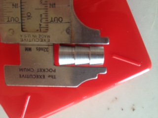

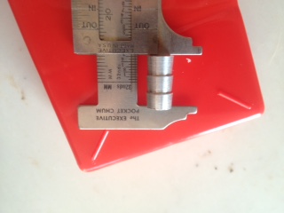

Webber kit came with a aluminum barbed plug. Why? For what? Engine is a g54b
Could you post a pic of it? I am curious what it looks like to help figure out where it does.
antifreeze plug?
The block off plug for the EGR valve pipe from the exhaust manifold?
Attachment 20007Attachment 200088mmX16mm
It's not even threaded? It can't even be used as a joiner (when the Mikuni is removed from the manifold, the bottom coolant inlet goes with the carb as it passes through the throttle plate as part of it, so there's nothing to connect the coolant T piece where the heater hose is bridged in) :shrug:

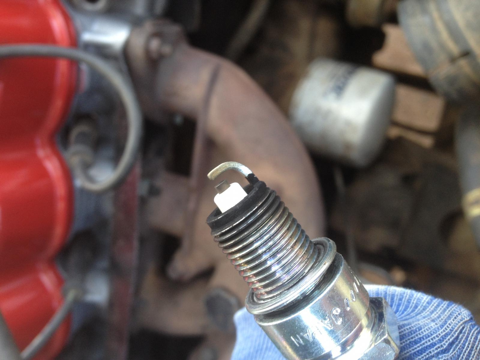

SOOOOOO. Before i opened her up i ran her slightly uphill at WOT in third at 4000rpm clutch and key off all at once. coasted in my driveway and all the plugs look just like #4Attachment 20014
not what i expected at 4300ish in elevation.

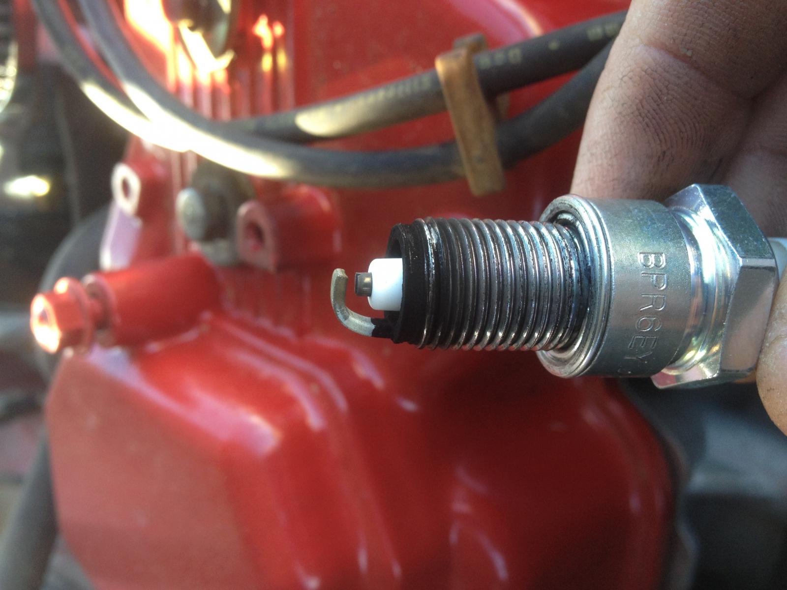

So here she is at idle after 15 min 750ish rpm. Plug #1Attachment 20015
So gas gas and more gas.
idle mixture is out exactly 1 full turn. idle adjust is about 5/8 a turn from contact.
Should i open up the air fuel mix before i start jetting. This setting is its best fast idle adjustment.
I think you are misreading the plugs - the insulator is what you read for lean / rich, not the metal threads. That insulator is white, which says it is lean, not rich.
if its lean I need more gas gas gas=power power and hopefully more power
I thought I'd be rich but I need lots more gas
do it in steps - small steps can make big changes

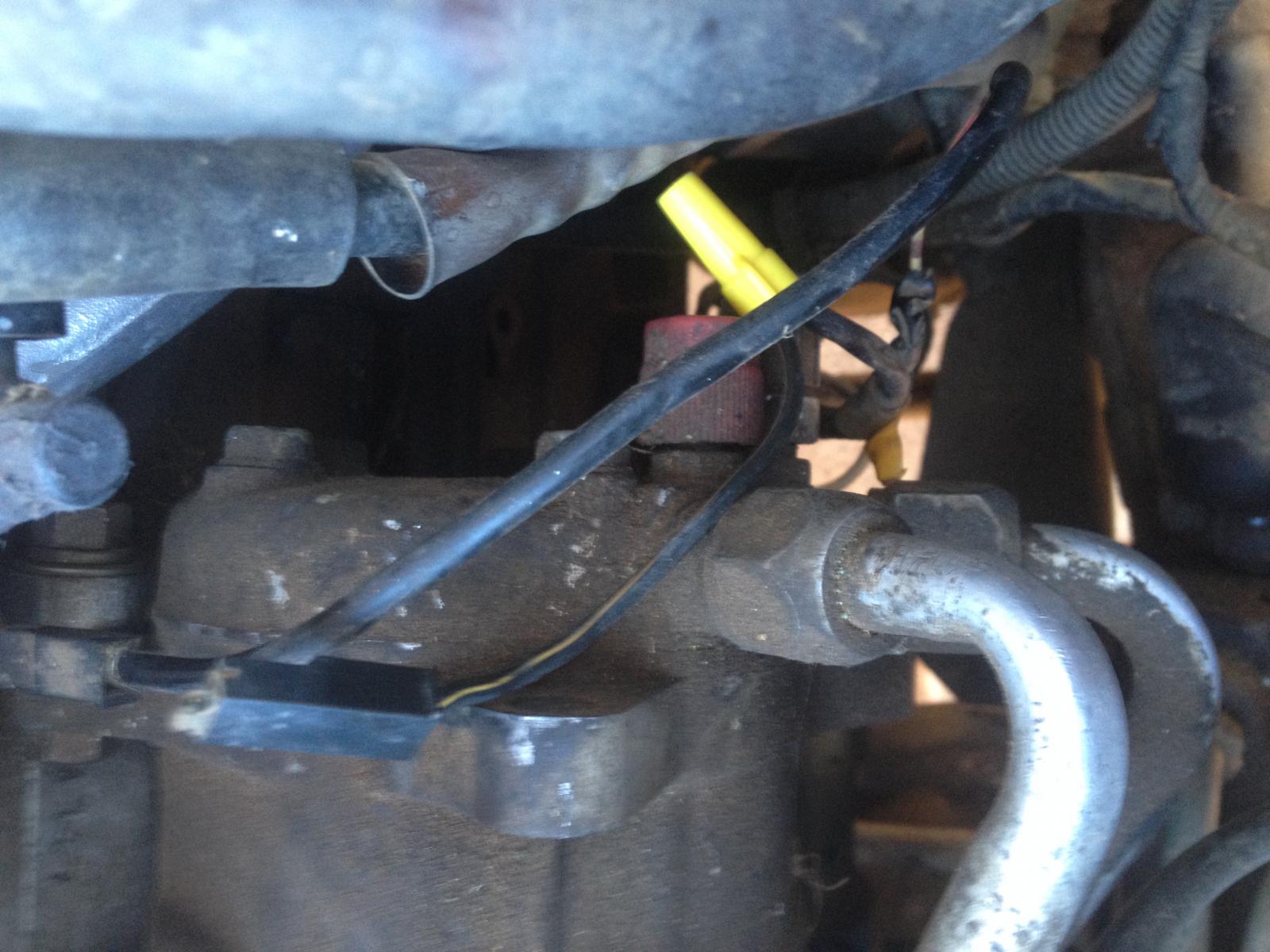

so its a bad pump. The temp sensor was fine i just hooked it up to the wrong plug. any one know what the other plug is for? I had it plugged into the temp sensor but it didnt work.
Attachment 20048
