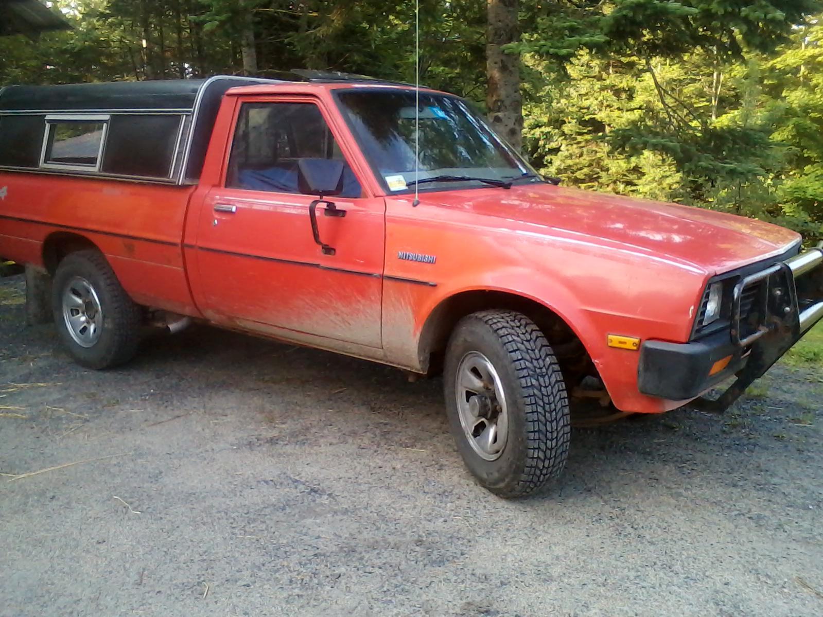

engine startup- growly noises-intake whoosh-vibrations
put in my used 2.6- it has better compression, doesn't smoke, has the non-jet head, Weber carb.
it "growls" at anything over idle- not unpleasant but it's way noiser than my old tired stock engine that was VERY quiet. why?
along with the growl is a buzzing vibration, felt through the foot, steering wheel etc. THAT is unpleasant, no idea where it comes from.
the Weber has a serious intake noise, anyone have tips to kill that?
Is there a way to see if the engine has the balance shafts installed without taking the motor apart? Maybe my noise is because of them being gone?
motor makes manly loud noises, but it doesn't seem to be super powerful. if it's not going to be fast, it should be quiet. any help wanted.
