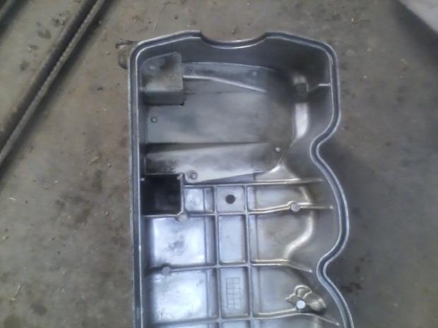

1 Attachment(s)
Looked over a spare head and cover I have out there it only looked like 2 places the studs might hit one is the drivers side back of the cover oil deflection plate for the breather hose and the next stud up has a smaller deflection box for a hole in the top cover above it but that stud would be installed wrong to be that high. The rest of the cover is smooth sailing the rockers are higher then the studs will ever be. The only 2 spots that protrude down into the rocker/stud areas are on the upper right of the valve cover pic. (Flipped over it's on the opposite side in the photo)
