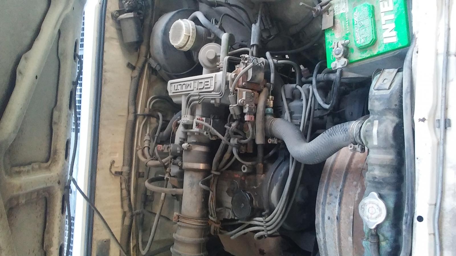

Dohc swap. Wanna confirm
So im getting ready to start getting the parts for my dohc swap so i just wanted to make a thread with the list i think i needto make sure i got everything correct. So far i got:
G63t 6 bolt head with intake(modded for rwd), fuel rail, etc
Sensors, ecu, and harnefrom 1g dsm
4G64 dohc cam gears
G63 headgasket
Then the typical water routing stuff with a full 63 swap. Am i missing anything?Attachment 19491
