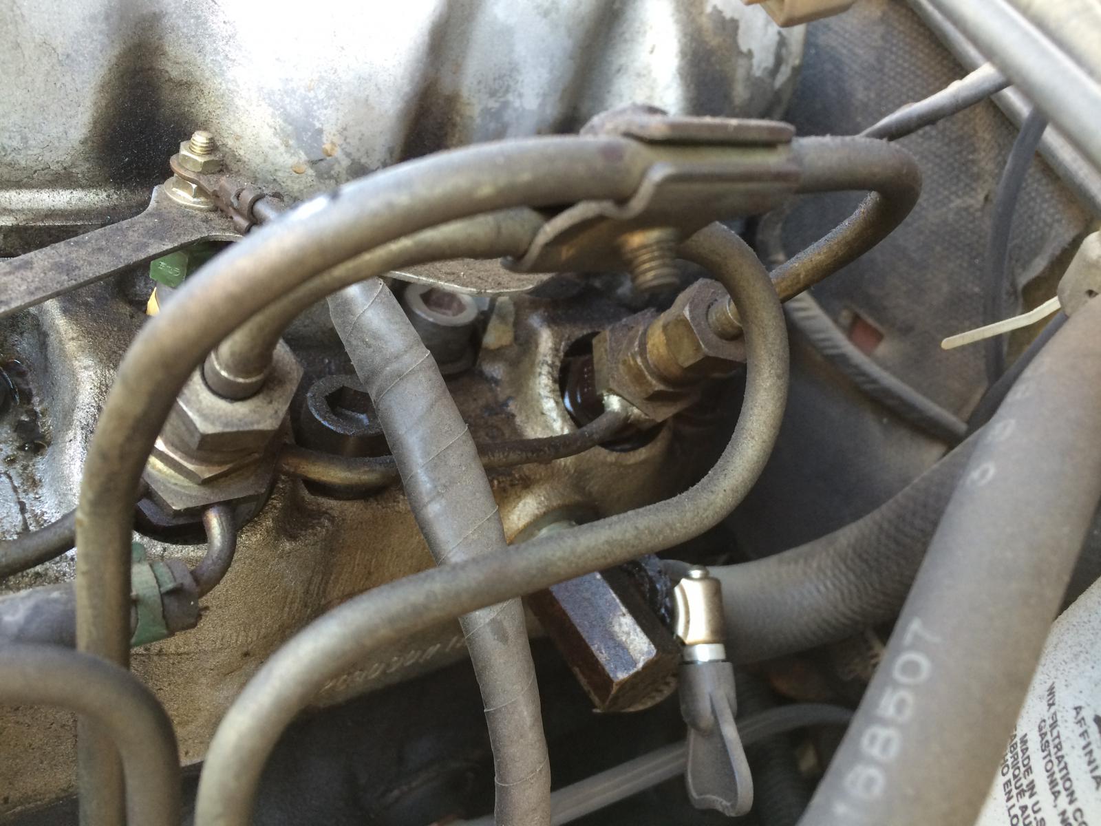

On an unrelated note, one of the fuel injectors is leaking at the return line that comes out of the side (see attached picture) it looks like someone tried to solder the joint in the past to stop the leak. The engine manual I have doesn't address the injector return lines at all so before I take it apart and potentially destroy parts that may be irreplaceable I thought I would ask for advice here.
